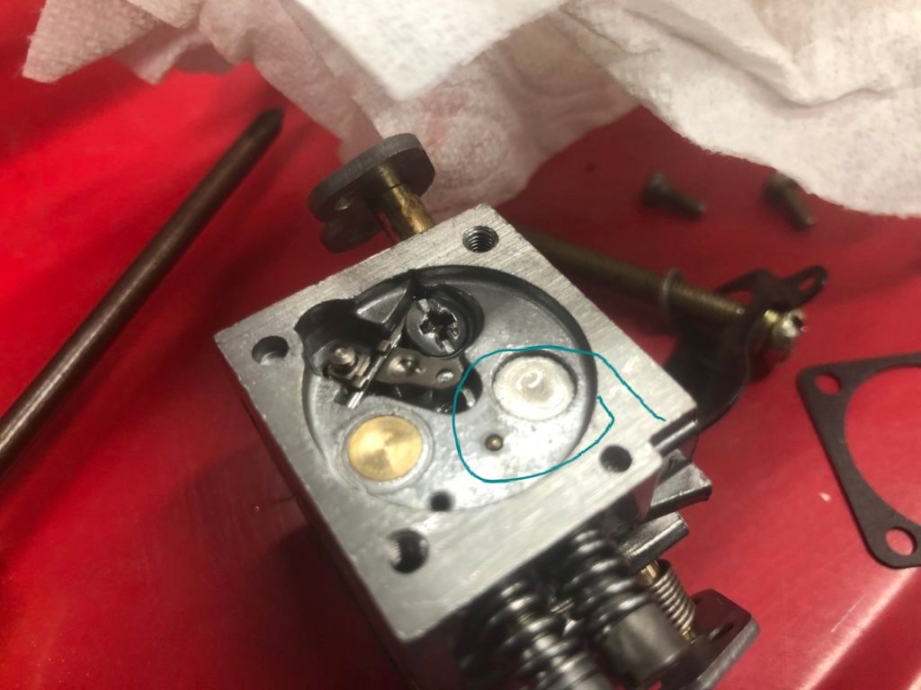

    I'm potato photoshopping but the purple circle is over the face of a needle that does not look like it has a Vinton tip. While the green circle IS a viton tip. The red is the Welch plug, you're correct not all have them

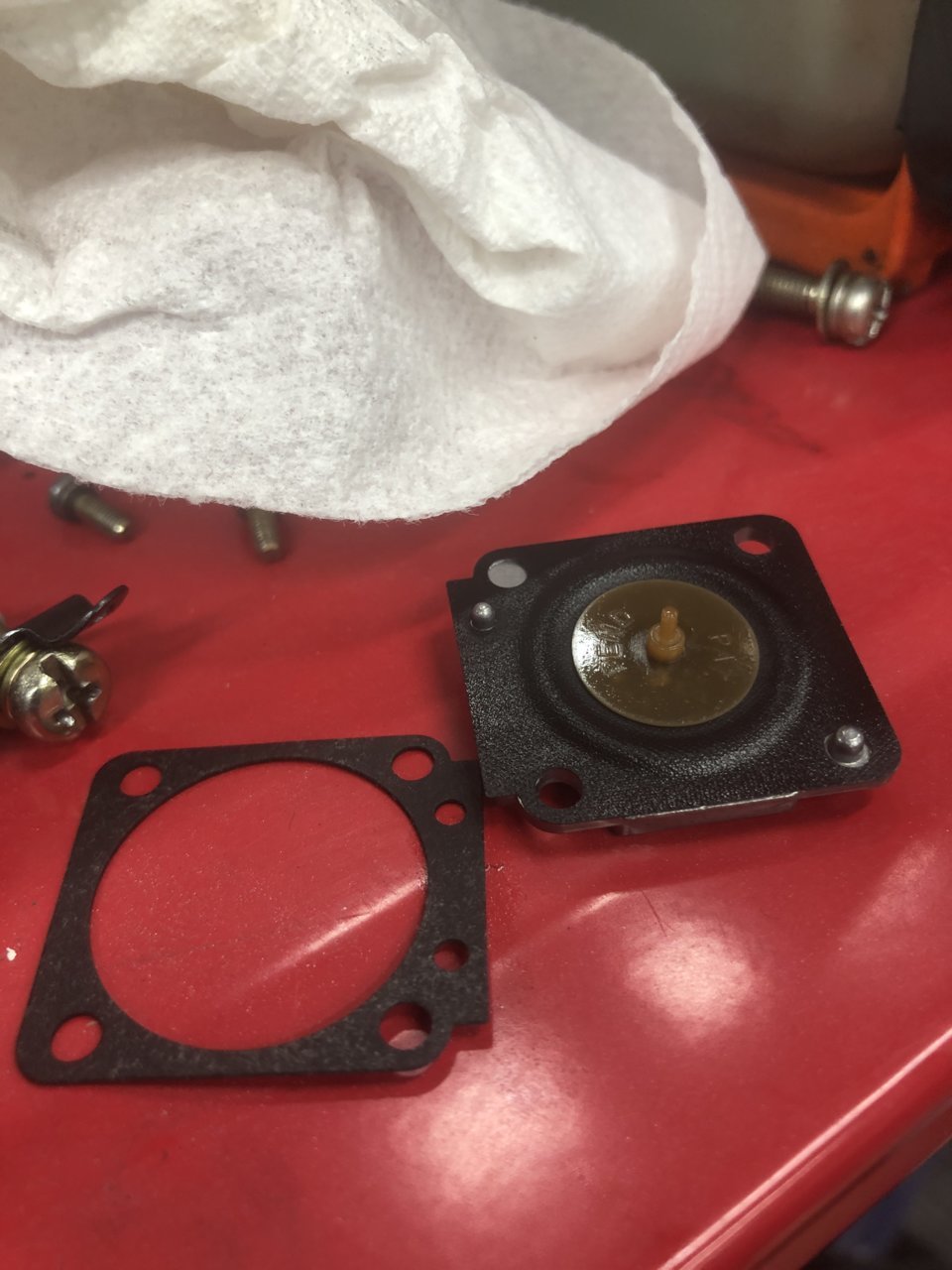

    Okay good, and you reassembled the diaphragms againt the body and the gaskets on the plate?

    Yeah, I put em on. It looks like it’s leaking out where the choke hole is. There’s too much fuel.

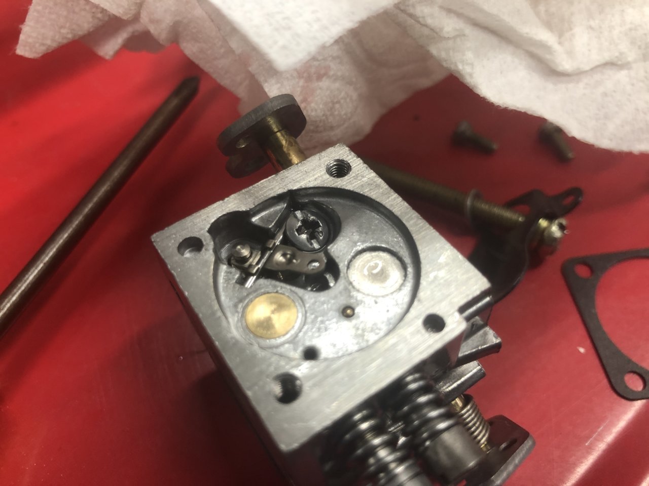

    That is the correct way to adjust it. But what about the needle tips? Were they exactly the same? If it's flooding out of there then it's not sealing against the needle.
    Also this is a Welch plug in your carb5052C6D1-9301-4943-87EC-9A688CF53B1E.jpg
    Check to make sure it's not loose at all.
