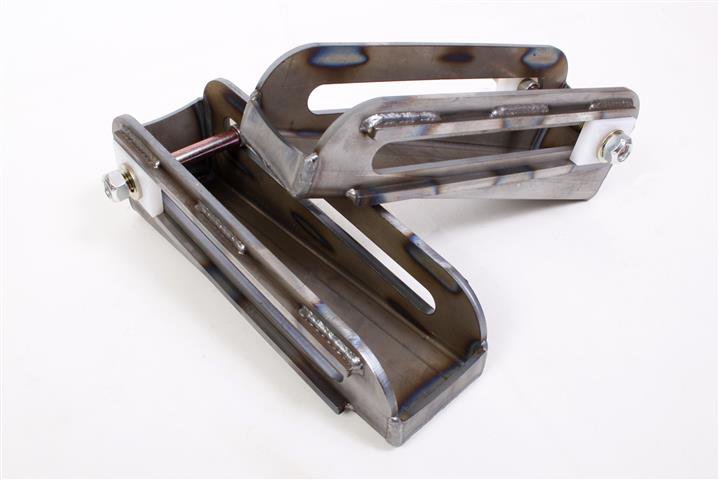

    I bought the hangers to be frenched in, remains to be seen if I'll do it, really only have one inch to do it.

    I also contemplated these

    You know I did too, but these ones are neat because they slide on some PTFE blocks, the ones I saw had roller bearings. Ultimately for ease of design I think a normal shackle is the best bet, I haven't done it before so I don't wanna mess up placement, I think the sliding blocks would work better for leafs whose center pin isn't equidistant from eyes, at least on a mounting situation like our rear frame. I got the TG spherical bearing leaf mounts cause why not.

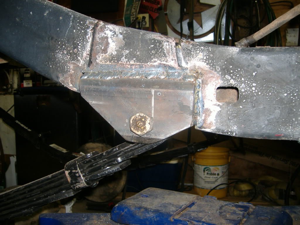

    Is that hanger recessed into the framework? What does that accomplish?

    I was worried about binding at flex cause it gets close to the edges. Probably just over worried on my part. Im sure that's been addressed on their end.

    That's what frenching is, putting something inside something else. It lowers the truck really.

    Lowers the lift.
