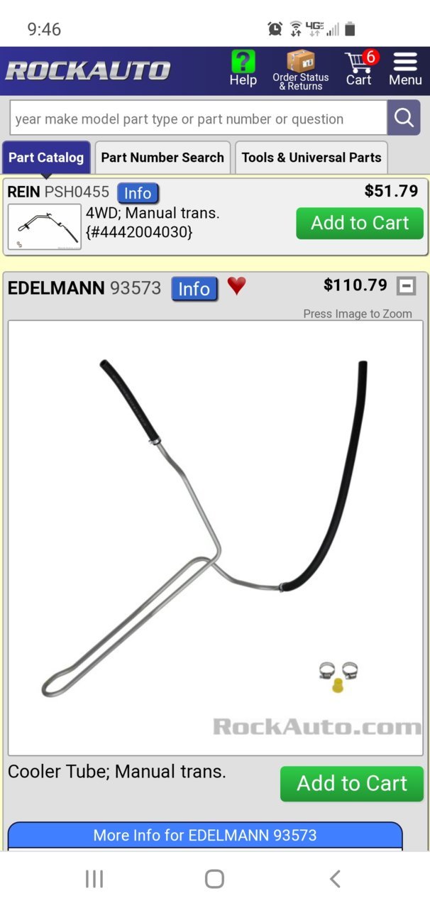

    So after rebuilding the power steering pump and rack, I figured I should replace the rubber lines as well.. looking up the return line, kits include the metal tube. Like thisScreenshot_20210316-094612_Chrome.jpg
    If I don't see any damage or corrosion on mine should I worry about it? Just buy bulk rubber line instead and replace that?

    I'd probably replace the bulk lines if your hardline is in good shape. It has been theorized the aftermarket hardlines have a smaller ID than OEM which contributes to PS pump and rack failures but AFAIK no one has measured both to prove that.

    Cool, thanks :)

    That what I would do. Mine was missing the metal part entirely so I plumbed in a proper power steering cooler instead.

    Do you have a manual trans?

    Of course.

    Where did you mount the cooler? And did you use one labeled for "power steering" or just a normal auto transmission cooler?
