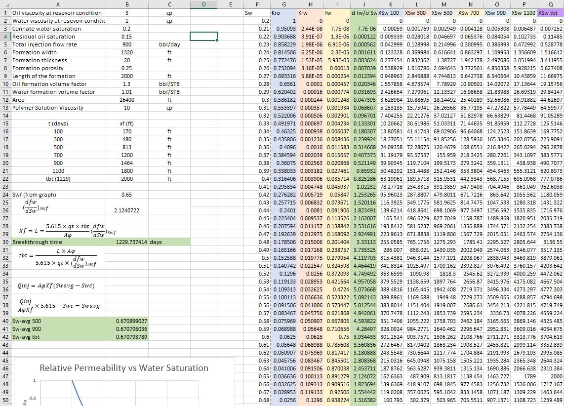

    What are you studying?
    To keep mine organized for professors I usually try to color-code columns and translate those colors over to graphs as well as label the graphs because that is most of what I use it for along with doing repetitive calculations on data. Any answers I highlight in green and it is pretty easy to add an equation in merged cells or a text box near the answers if your teachers want it.
    Adding multiple pages for different sections helps clean up data and you can still use data from earlier pages in equations on later pages.
    Whenever I don't know how to do something usually google can give you a quick answer. If something seems cumbersome usually there is an easier way to do it that you can find on google.

    Environmental Engineering, you?
    Honestly, after I got through the first problem it got way faster. Just getting in the mind set I guess.
