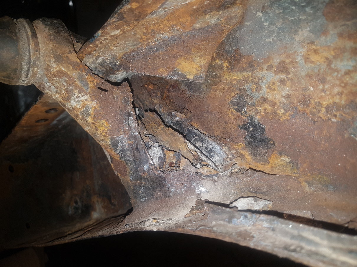

    Yeah, that frame looks rough but mostly surface rust hopefully.

    Oh, that'll be fuuuuuuuun.

    It's less Tacoma and more mod
    All the parts that can be seen are plenty solid still weird enough. The bad rust is in the back 6" of the boxed sections. The c channel bit will clean up great and everything forward of the rear body mount is 100% fine. So I've got about 18" of stuff that needs real cleanup.

    Not too bad. Still a pain in the ass tho.

    Worst parts of mine were in the boxed in sections at the back of the frame. They just hold mud. The shock mounts too, but it sounds like you're cutting those off anyway.

    Any tips for cleaning it out?

    I cut them out and welded in new pieces, but I'd start by just stuffing a hose in there and washing it clean. I didn't see much in the way of drain holes so it needs some decent flow to flush it all out.

    I was gonna pop 3/8 holes ina couple areas anyway, truck gets dunked often in trips anyway

    Yeah thats a good idea. The should have designed more in. I left a few that I can stick a nozzle in.
    Although with the removable bed on the flatbed, cleanup is gonna be a whole lot easier now.

    I'll give em a shot, gotta repaint the rear anyway
