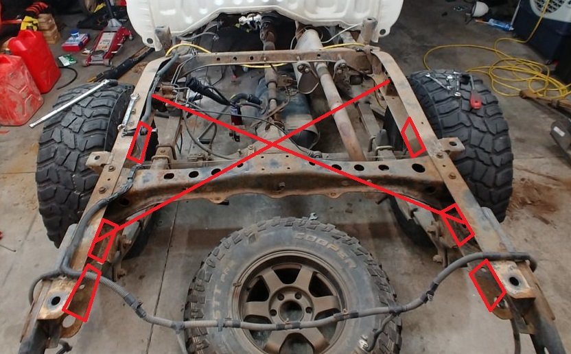

    It's less Tacoma and more mod
    The outside walls are certainly thinner, but in structural steel terms that's called the web and it's not nearly as important as the top and bottoms, I was thinking I'll just plate the sides and eventually get rid of that rear cross member to build an x-brace

    Yeah, the web. Thats the word.
    I plated the outside, re-boxed the inside forward of the leaf springs, and called it good. Feels stiffer (and I can't see the bed wiggling in my mirror anymore...)
    Got any pictures of this X brace idea?

    The boxes will be from top to bottom of the channel to make stronger tie in places, the rearmost boxes are to reinforce for the new farther back leaf mounts of the Chevy 63s

    Maybe, somehow I've earned myself a helper on this project so I'll have him get more pics than I usually do working alone and see if I can fashion that into anything useful at the end. I'm kinda working off general knowledge from YotaTech and tips and locations @drr gave me, I'm certainly no expert

    Yeah, probably lift the body off the frame about 4" and clean about halfway under there too, it's not very rusty under there at all but still would be nice. I'm gonna strip as much off as I can with those debris and rust remover things @0xDEADBEEF linked and then I will hit the little reinforced box areas with a abrasive blaster too.
