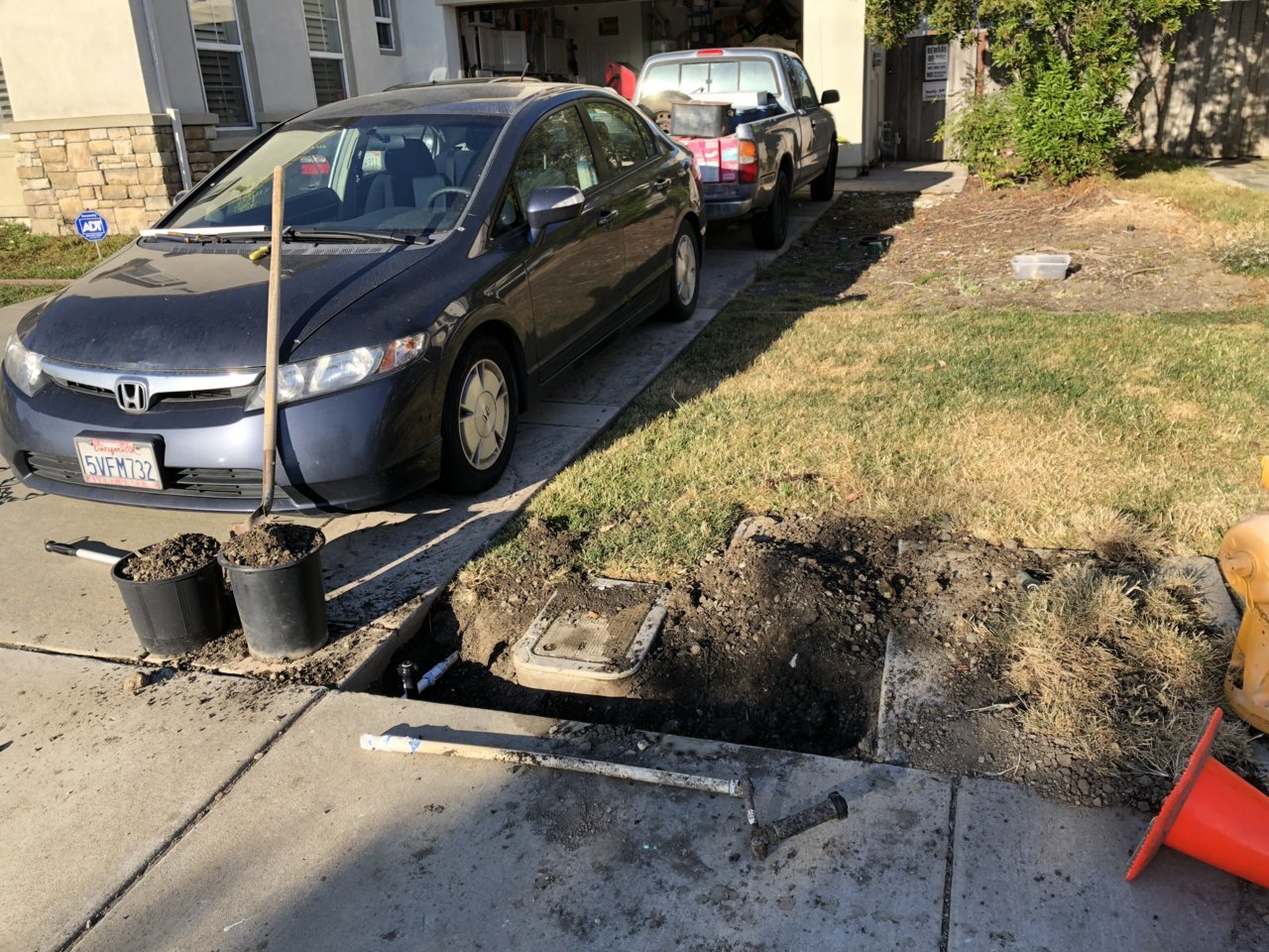

    The Schedule 30 PVC I was using is plenty strong, it’s the joints where it fails. I still have to convert to the original 15 year old brittle water piping and I can’t cement certain ends because I would never be able to maneuver the pvp pipe onto it.
    My plan is to rip out that corner of the plumbing and try again with all new piping because everything is so tight knit I can’t seal everything properly.

    I did a thing
    ft. my two useless cars

    You need to buy the expanding quick fix sections for PVC. I'm sure how you're trying to fix that shit without them. The pipe will never be inserted deep enough into the fittings if you're just trying to flex the pipe.

    I don’t think any dog in the world could dig up my soil.
    My subdivision was built on former salt flats and marshland. The soil is 80% clay and 20% rock.
    The only thing that grows is weeds.

    I’m going to have to end up doing that. The way Standard Pacific laid this pipe is horrendous. It’s all crooked and botched with couplers, and put stress on the fittings causing it to fail like it did.
    I think I’m just going to cap the right side off. That’s just adding to the problem.

    Sounds like you need to just pull it all out and do it right...
