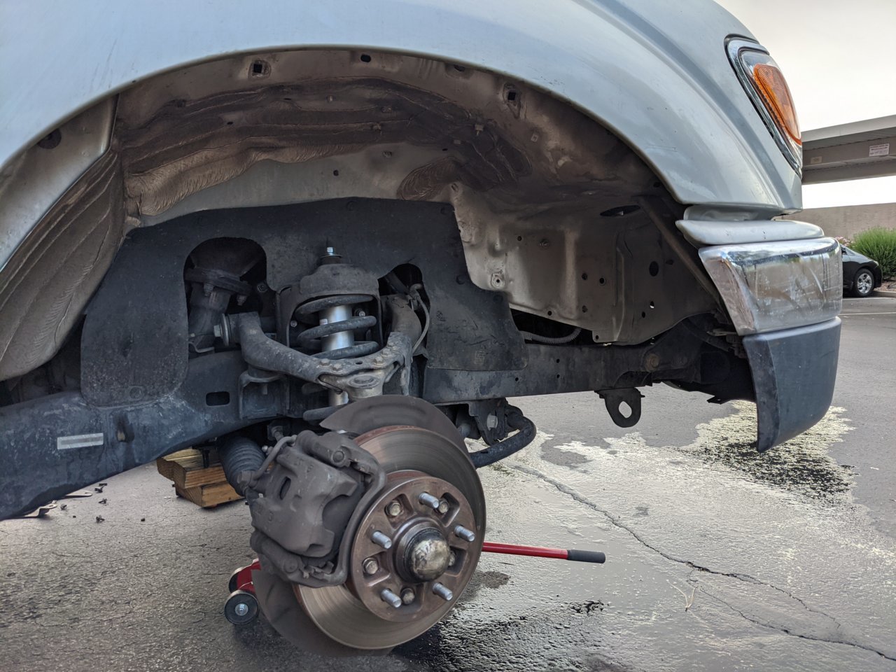

    Ite. Time to pull some plastics from the slug

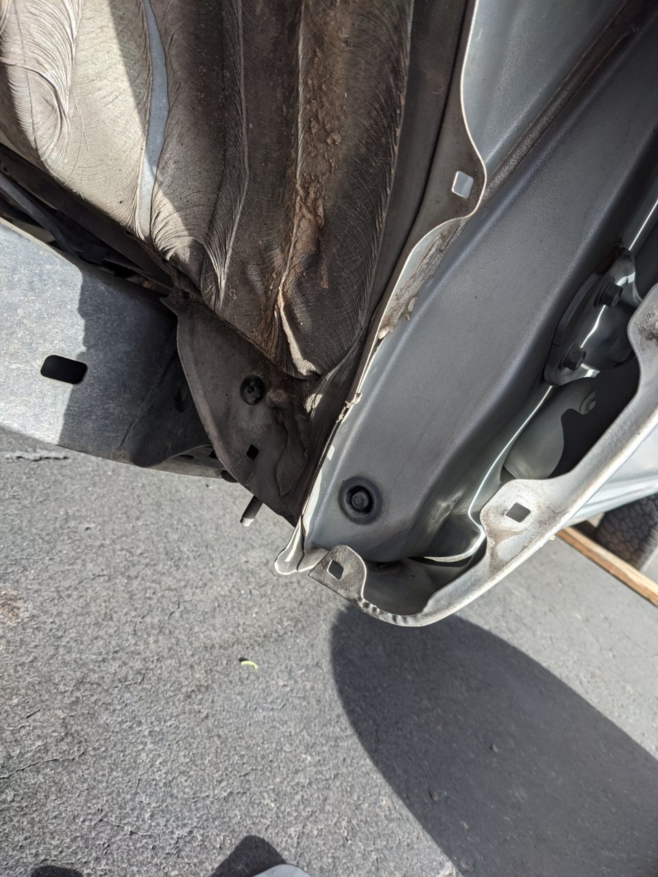

    Likely will sound dumb, but what's the pinch weld here

    To clear bigger tires you're gonna have to trim the red back and possibly bash in the yellow section depending on how bad you rub
    Whether you cut, trim, fold or bash is up to you and how much room you need

    Just what I needed, thank you.
    Got that bitch out the passenger side after a bit of fighting too

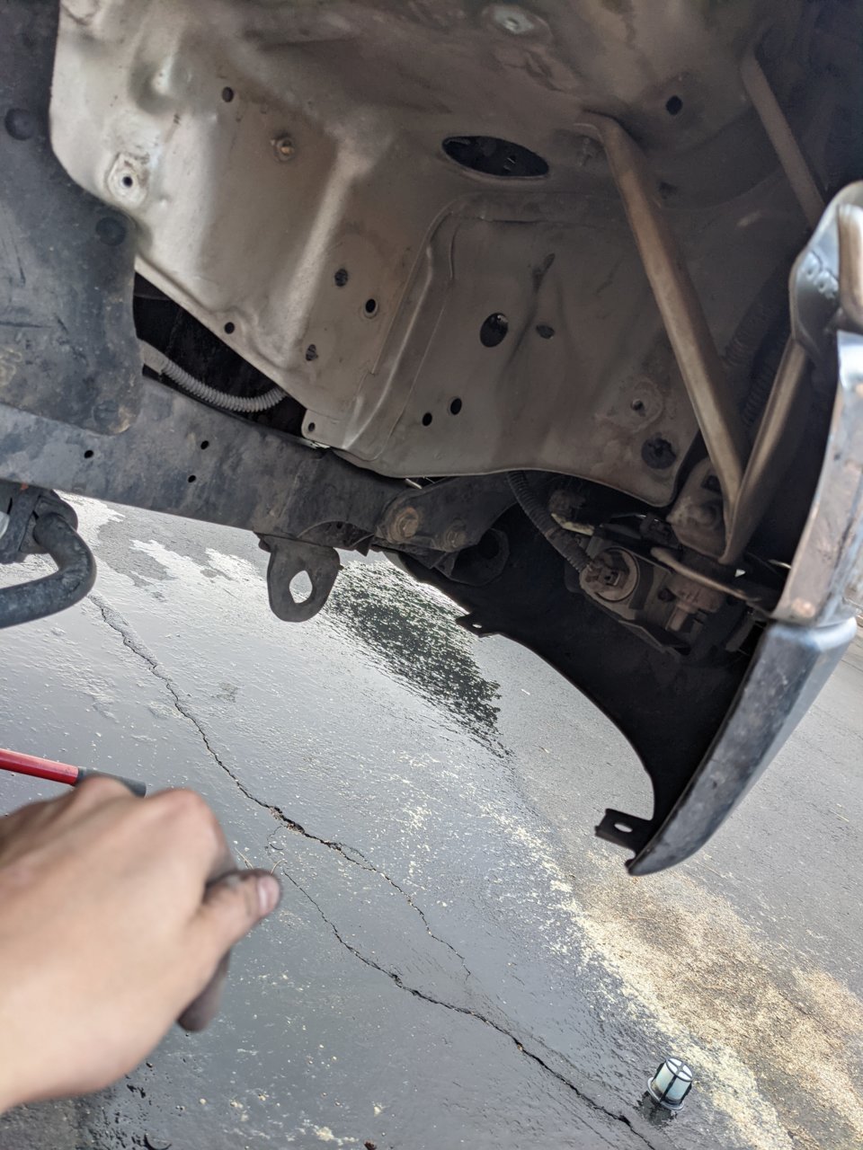

    So much more room for activities! Likely gonna try and cut Friday

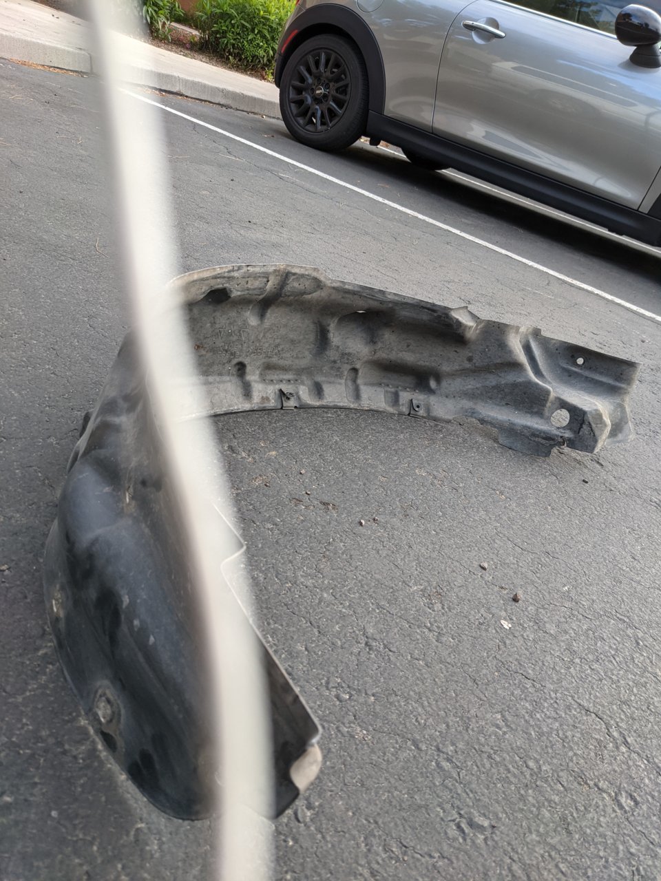

    Trash then or keep? My tabs will be gone after I cut some of the fenders off

    Throw them on Craig's list

    Keeeeep
    or your door jams will never be the same

    I don't know about the 5 lugs, but the fender liner on the 6 lugs is what keeps water from getting sucked up into your air intake when you hit mud/water pits.... Without it you can suck up a lot of water and do damage, on that side at least

    Guess I'll hold on to see if I can throw some screws on it elsewhere to hold them, thank you guys.
