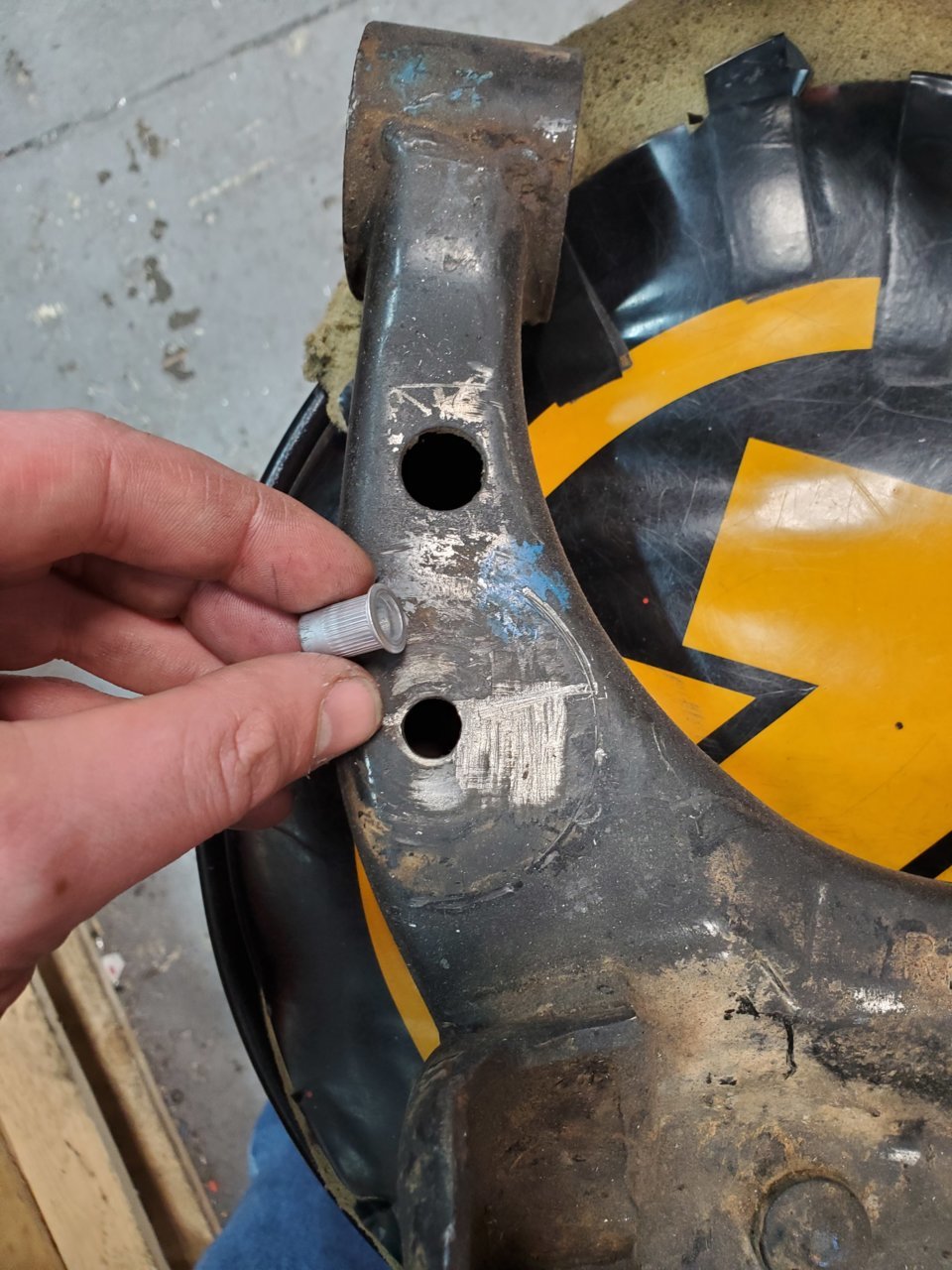

    You can do what I'm going to do and drill the hole slightly larger then install a pop nut.. like a rivet but with threads.
    This is an example but the wrong size. I need to order the metric ones20210506_121856.jpg

    Man I'm learning all kinds of cool ways (and names) to use rivnuts these past couple days haha
    Yeah I had originally thought about doing something like that, drill a hole big enough for a long socket and maybe just put a nut on the end of it. But I need to replace that LCA now anyway to hopefully correct my alignment issue
    The JB weld works surprisingly well, the only reason it came off in Moab was because the shop that did my LCA bushings knocked it off and I didn't notice until we left for Moab, so I used one of Nelsons and zip tied it on. No surprise there, zip ties do not work well to hold a bump stop on lol.
    The JB weld works because the bump strikes the plate in the vertical up/down motion, but if something hits it from the side it comes off easily.

    They are awesome little devices! We use em alot at my new job.. those as well as PEM fasteners, which are very similar but different
