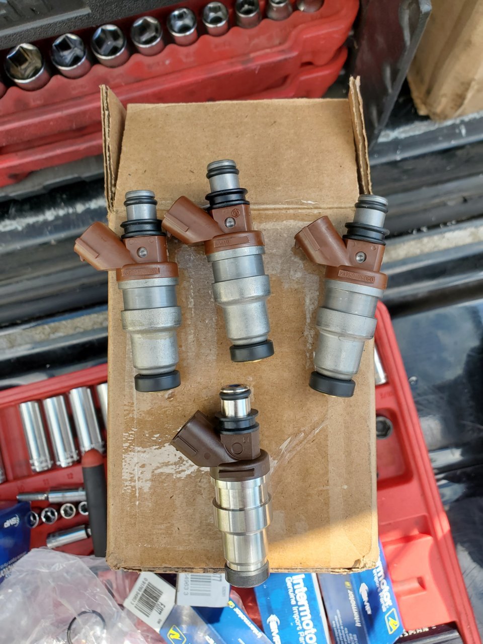

    One of these injectors isn't the same... but all cam in the same marked box. Should I be worried?20210509_152528.jpg 20210509_152620.jpg

    @Speedytech7 20210509_152823.jpg And should I be worried one of these rubes is slightly deformed?

    The 2 hole are stock for the older 3rz, that other is aftermarket. I wouldn't run a non matched set especially when the spray pattern is different. the system isn't designed to handle different injectors in different holes. I'd buy a full matched set

    It was supposed to be a full matched set when I ordered it:pout:

    Rockauto.com
    Ordered 4 of the intermotor brand "new" ones p/n FJ377
    I think only the one different one is actually new because the other 3 have Denso numbers on the side of the brown plastic
    Would you run one of the old ones till I get another that matches?

    Eh, i'd just wait until you get another new one. Tel rock auto you want an exchange. They clearly rebuilt a cheapo aftermarket unit

    Cant wait cause this is the DD and I gotta get to work also... Yea.... im a jackass and ordered these 38 days ago and can't return it cause I waited too long to install them

    Welp, imma just run the new off pattern one till a replacement comes in. Truck starts great even with the mixed set and it's missing that noticeable stumble when the AC compressor kicks on like the old ones had.
    So imma say I definitely needed to change em:laughing:
