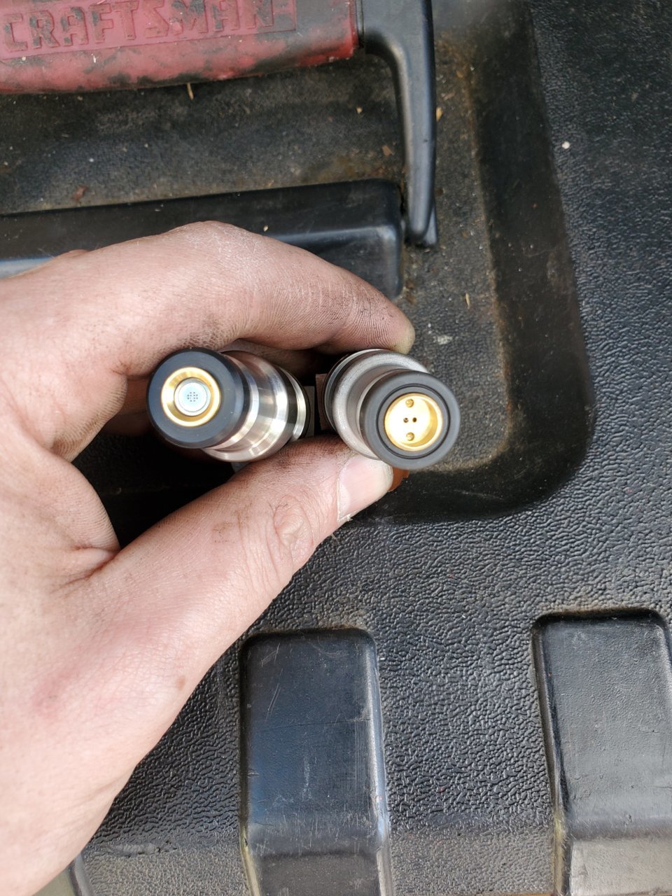

    They should all be new and should be matched. That's a premium priced injector. I can see the design changing like one for the 5VZ between 98 and 99 models. The should all be the same. I cant recommend Rock again after seeing this.

    The 3 Densos are new reboxed from Japan. The 1 different one must be from their Greenville SC USA plant. I think I saw a wrapper with made in USA in one of your pictures.

    They should all be new. I think the different one is from the Greeneville SC plant vs. reboxed from Japan.

    The Rock link points to injectors made in Greenville SC. They changed and we're seeing the change.

    All four boxes say made in USA on them, although you are correct and 3 injectors came for 1 warehouse while the 4th came from a separate location.
    Would you worry about the different nozzles after seeing this pic?20210509_152620.jpg

    The 12 is technically superior

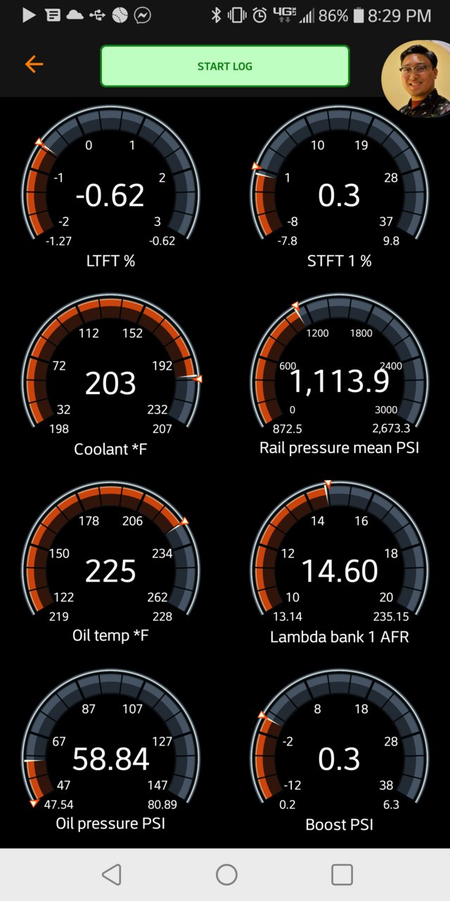

    It's less Tacoma and more mod
    Those fuel trims are looking pretty damn good
