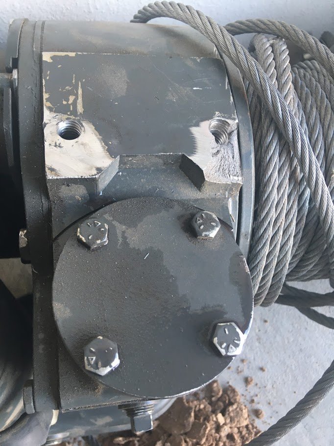

    Finally got my Ramsey RE8000 back from the machine shop. Set it down right side up in the garage and oil came flooding out of the mounting bolt holes. It appears the shop drilled straight through past the depth of each mounting hole. I didn't notice when I picked it up since I was rushing to get back to work.
    Told my old roommate (who convinced me to buy it a year ago) and he just said "lol I'll take it off your hands if you want" which means free winch for him. I can't weld aluminum and won't be in the position to do so in the near future. We are back on speaking terms since we had to in order to move out of that house. But we obviously aren't friends after he said that.

  9. May 21, 2021 at 4:43 PM
    Speedytech7
    Feb 20, 2014
    #123587
    58,403
    FCQM+VG Cheney, Washington
    It's less Tacoma and more mod
    Cheat and use thread sealer on the mounting bolts haha

  11. May 21, 2021 at 4:49 PM
    04Pre_Runner
    Feb 9, 2017
    #210143
    4,909
    Andrew
    2004 DC Tacoma SR5 4WD V6
    That's just feels like such a hack job. And a headache down the roads if it starts leaking. I want to know why the machine shop ignored our agreement and just said drill press go brrrrr.
  12. May 21, 2021 at 5:02 PM
    Speedytech7
    Feb 20, 2014
    #123587
    58,403
    The place I worked would have caught that mistake and had it welded and tapped to correct depth if they made the mistake.

  13. May 21, 2021 at 5:11 PM
    Empty_Lord
    Empty_Lord Toyotaholic
    Mar 13, 2016
    #181186
    28,298
    Dan
    Northwest Indiana/Chicagoland
    Use some pipe thread sealer and put it together, probably won’t have an issue. But yea. Super shitty
    I had a machine shop drill through an oil galley on an engine... they paid for a new block... my buddy said fuck it and he sealed it with pipe tape shit. 5 years later still no leak

  19. May 21, 2021 at 5:40 PM
    04Pre_Runner
    Feb 9, 2017
    #210143
    4,909
    Andrew
    I’ll call the shop Monday and go from there. I’m just not interested in using thread sealant.
  20. May 21, 2021 at 6:26 PM
    04Pre_Runner
    Feb 9, 2017
    #210143
    4,909
    Andrew

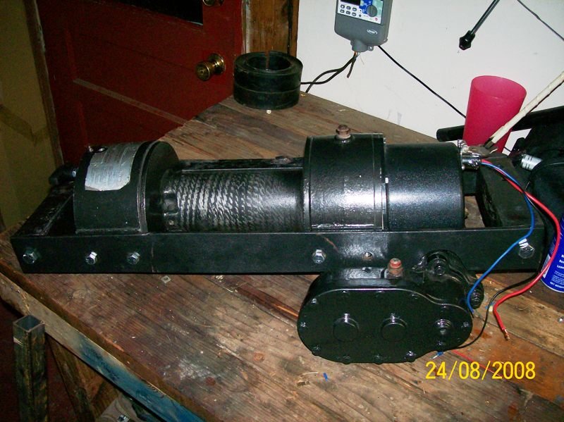

    Plan was to just deal with the slightly fewer threads on that one bolt. There are 8 mounting bolts so it didn't seem like a big deal. But those two bolt holes in the picture go straight into the case now. They normally mount like the bottom picture.
