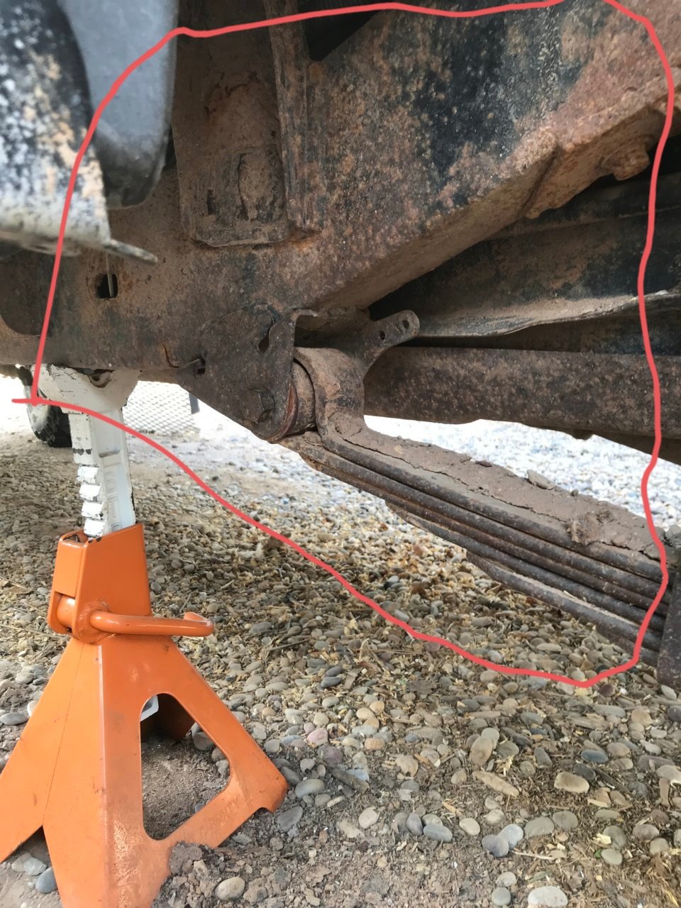

    Haha yeah the one right next to the gas tank is no fun.
    IIRC I was able to back it out a bit with a wrench while leveraging it out with a pry bar at the same time.
    But I don't deal with seized bolts so...yeah...have fun with that

    Everything else is off on this side toooo

    Yeah I dunno, someone from rust country is going to have to chime in. The way I get that one off probably won't work if it's seized in there, maybe heat the F out of it, I dunno. Melt that poly bushing and turn it into a s'mores

    Sawzall between the leaf pack and the mount is how you cut the bolt. Got to do it on both sides

    I sprayed them with stuff tonight, the bolts not froze in the bushing, so that’s nice. Might go buy a little benzo torch tomorrow, and some more blades

    Could be seized in the metal bushing sleeve though?

    I can make the bolt spin, until I get a wrench to the gas tank to hold the back side, so maybe, maybe not
