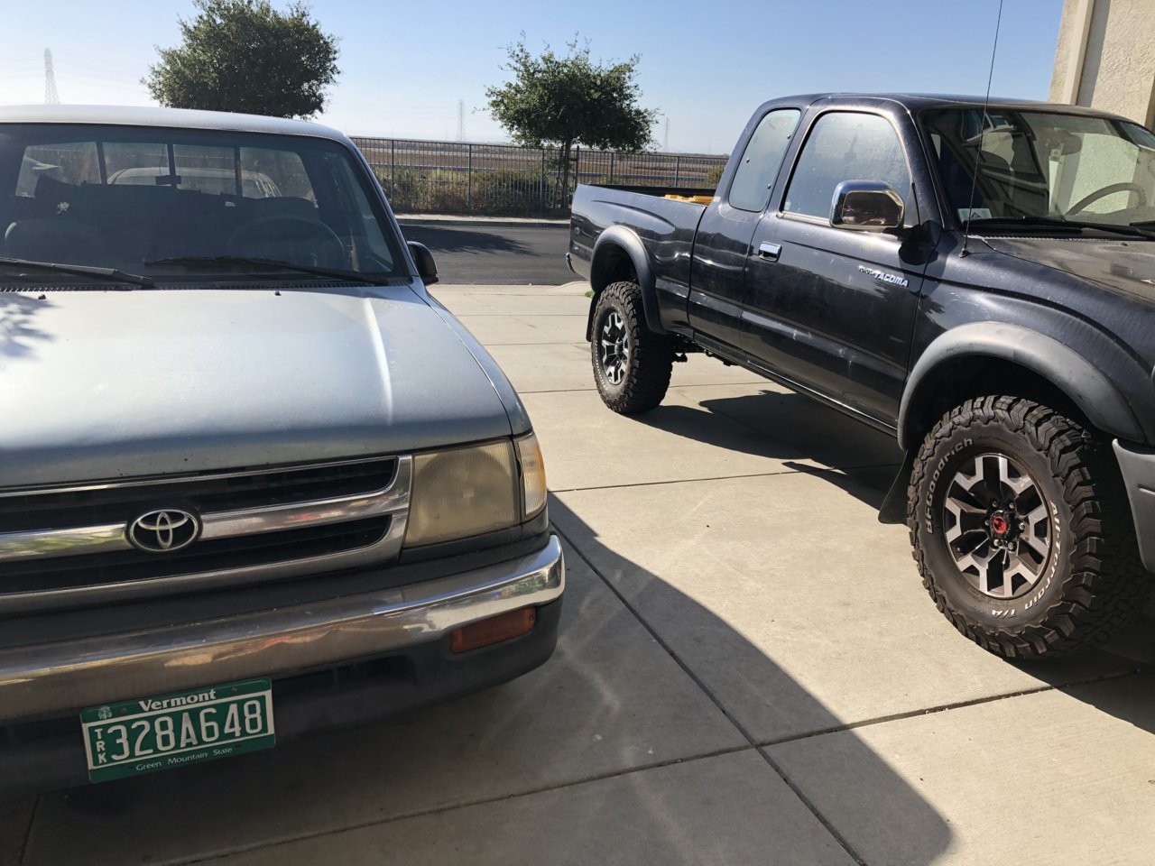

  11. Sep 21, 2018 at 4:26 PM

  12. Sep 21, 2018 at 4:31 PM
    FLBAdrian
    FLBAdrian A Pretty Sizeable Onion
    Oct 25, 2016
    #200619
    2,633
    Adrian
    Hanford Ca,
    1996 X-Cab 3.4l 2014 Tacoma crew cab
    Too many…
    Time to lift the front?
    Sperrunner and Crodell6 like this.

    maybe it because the driveway is super sloped, but it actually looks level in that pic.

    holy shit get new headlights.
