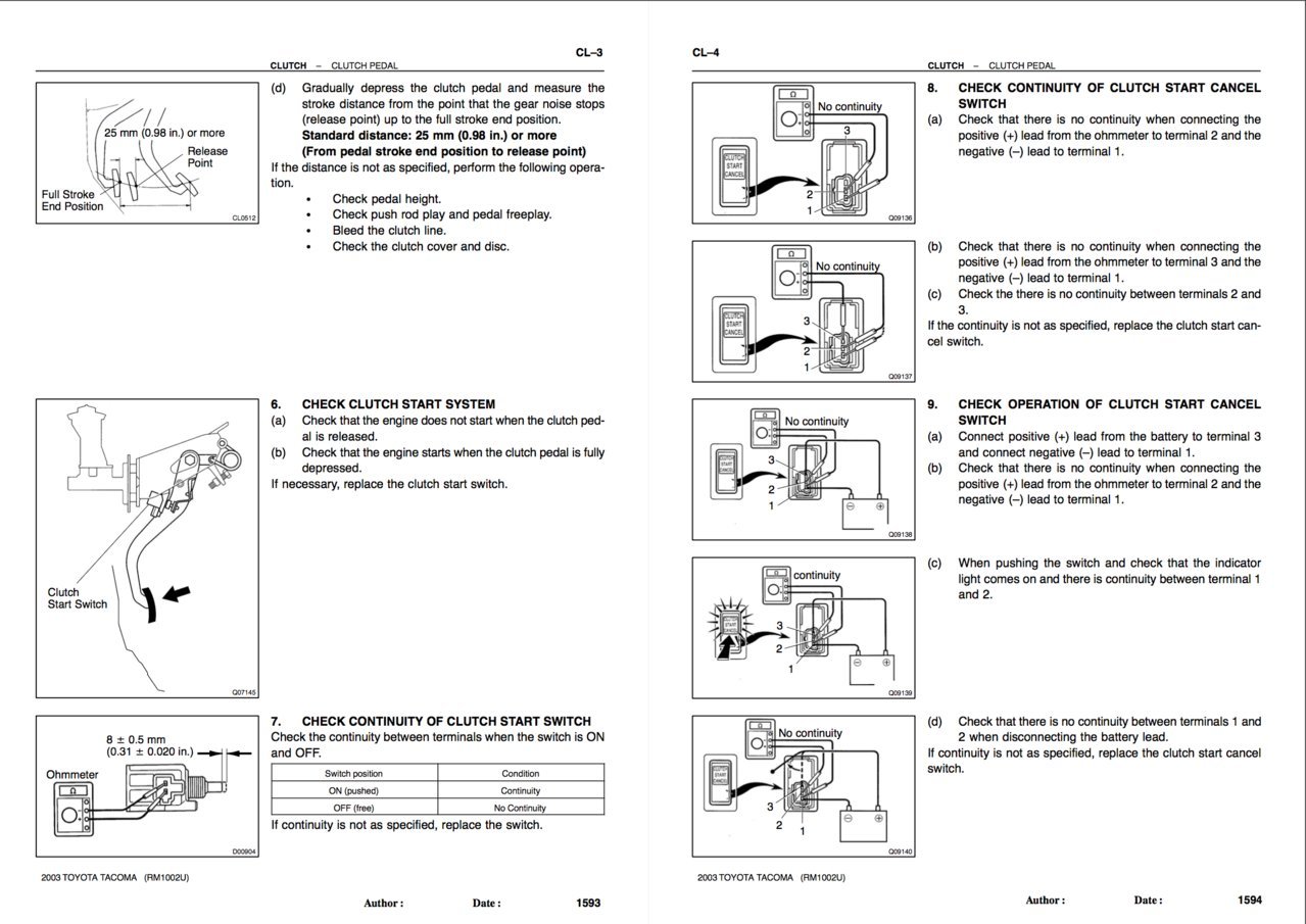

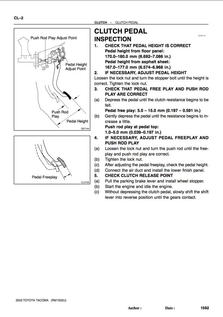

    Got it. I guess I’ll ask again when I put it in I’m concerned about adjusting the push rod and what not when In the vehicle
