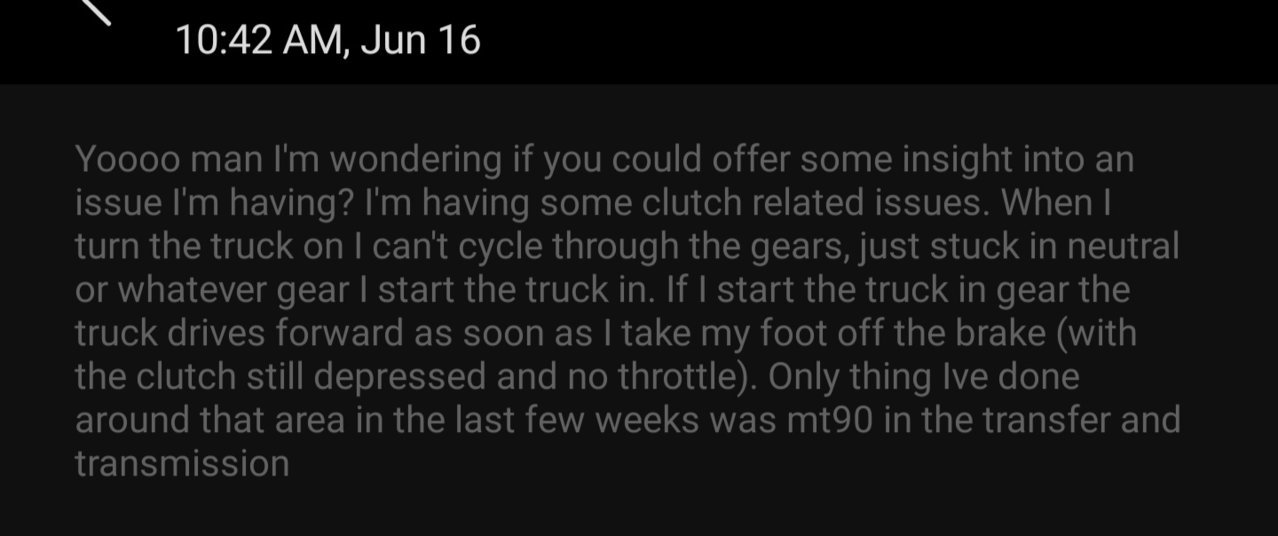

    Master or slave clutch cylinders would be suspect for me. Is there enough fluid in the resivoir? Leaks?

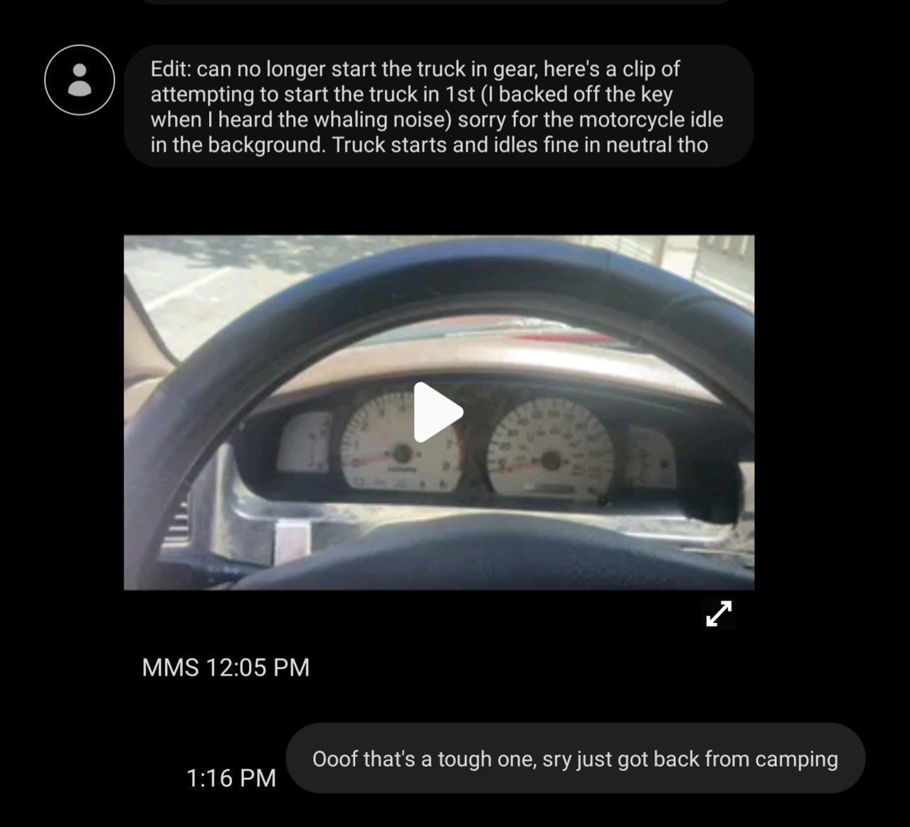

    yep have someone press the clutch and look at the slave cyl on the DS of the transmission to see if it's moving the clutch fork.

    This or possibly the clutch fork bent/broke

    also if it is clutch master/slave cyl you could try pumping the clutch pedal a bunch to see if it builds pressure enough to disengage the clutch and go into gears

    Do clutch forks do this often?

    Extremely rarely
