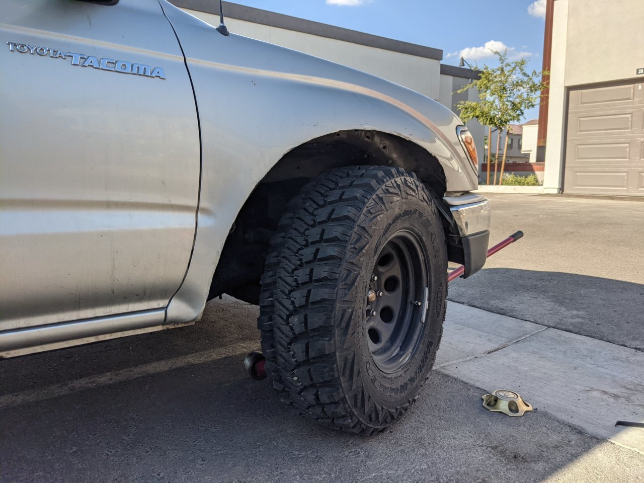

    Lil bit tight. Rear seems to be good, just pinch weld area and trim the bumper

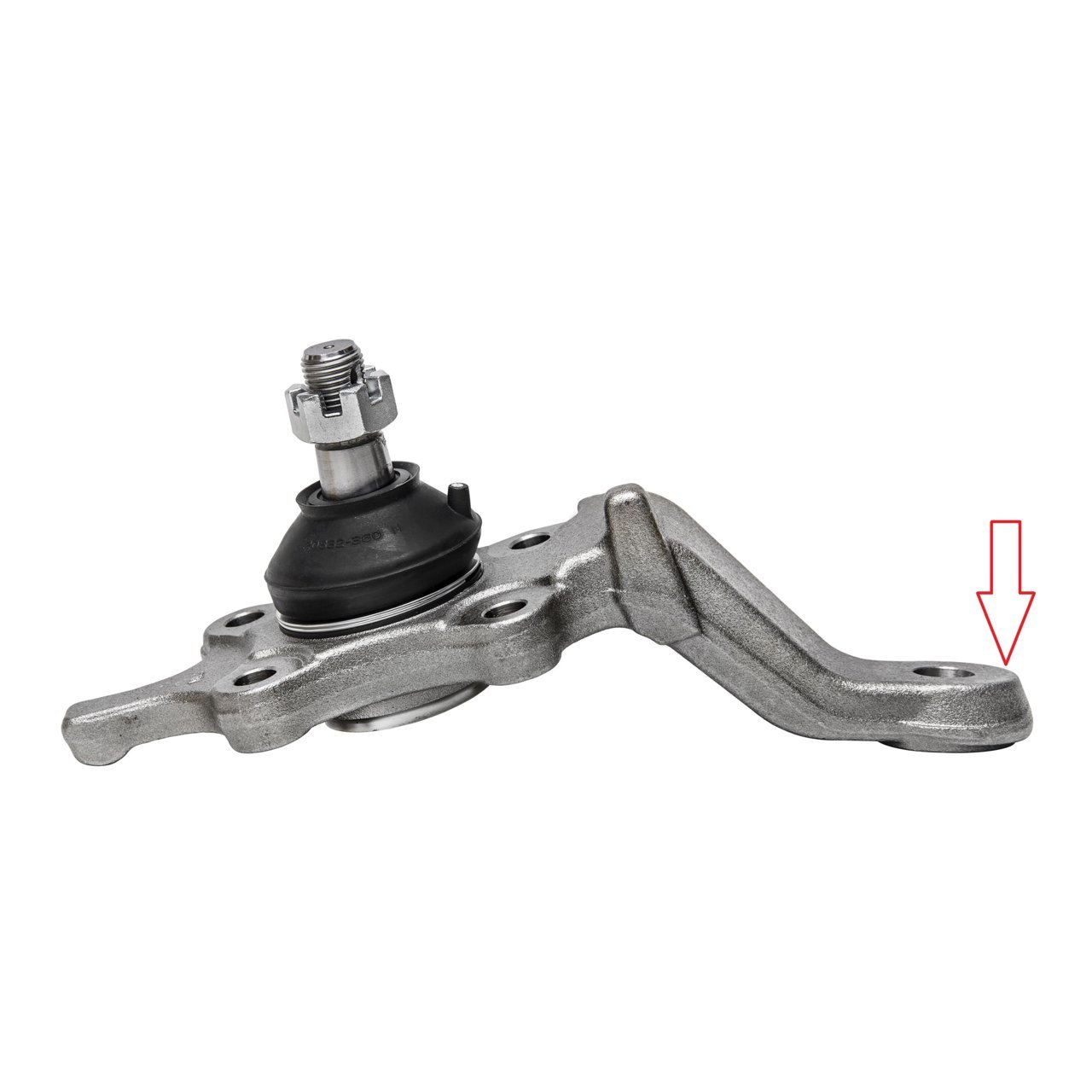

    Add some heat to the back side of the ball joint near the tie rod. Smack the side of the ball joint on the side. I have had them pop out like cone washers do.

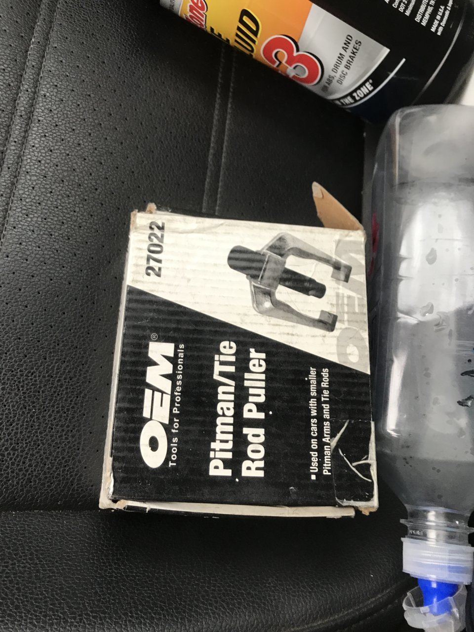

    No it won’t, too small.
    So I just it the tierod harder and off it came

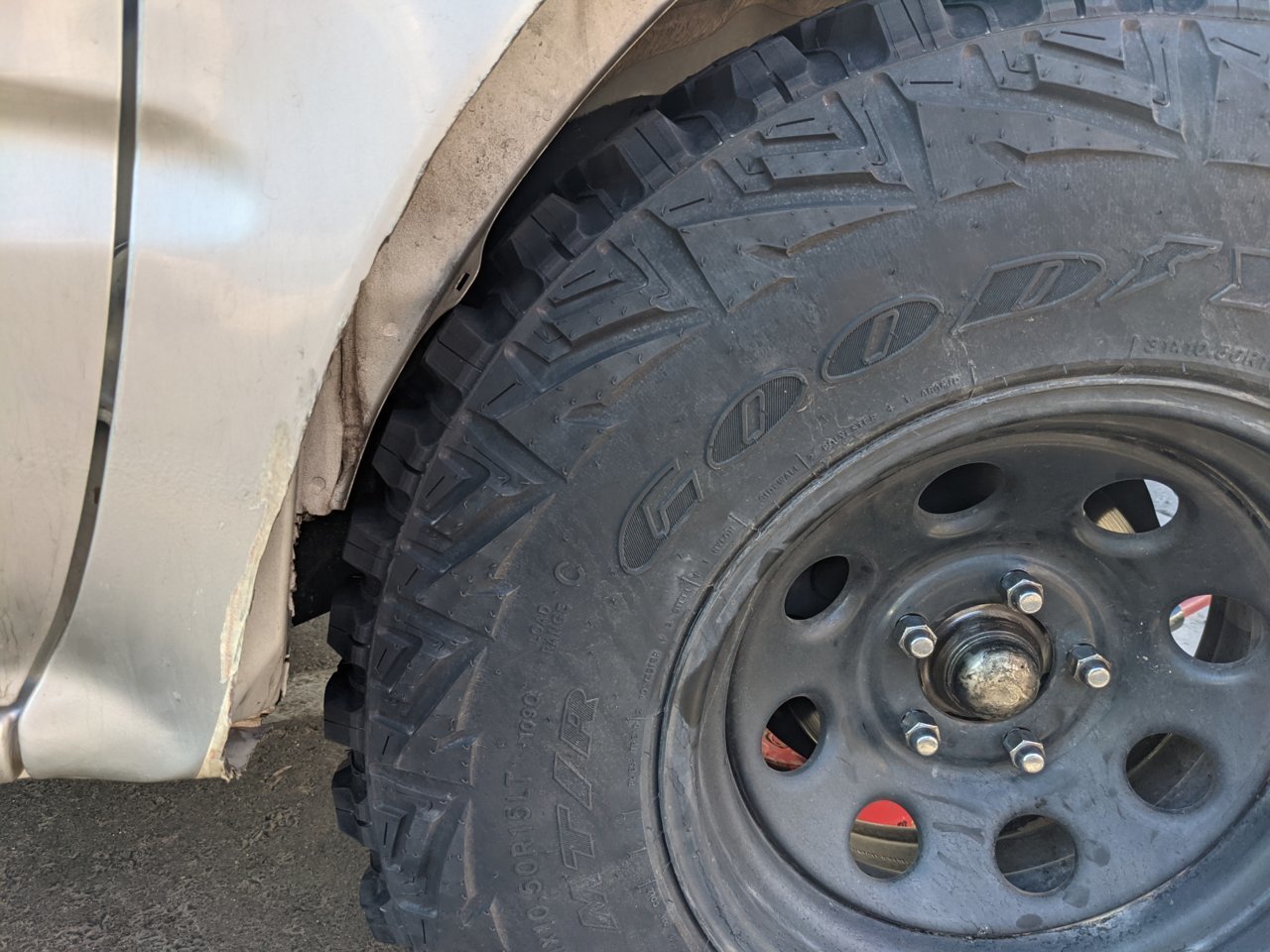

    :rofl::rofl: appreciate it, but I was just test fitting for my own set coming up! I have a discount tire down the street and wanted to see how bad the tires would rub omw home to finish fitment. Seems that back pinch area needs some good massaging.
    How back could I comfortably push that area with a sledge before risking cracking? Just enough to match the contour?
    I'm stock rn, but have a lift laying around for it. Alignment will come at that time
