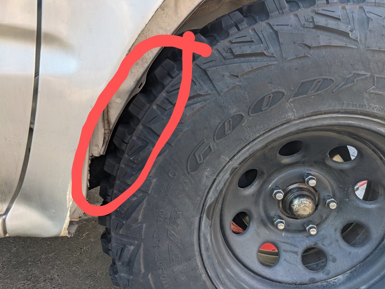

    It's less Tacoma and more mod
    That seamed portion doesn't really smash back, that's the part people cut out typically for clearing 35s. You could hit it but if I was a betting man I'd say it would probably crack at the seam and separate the floor from the wall

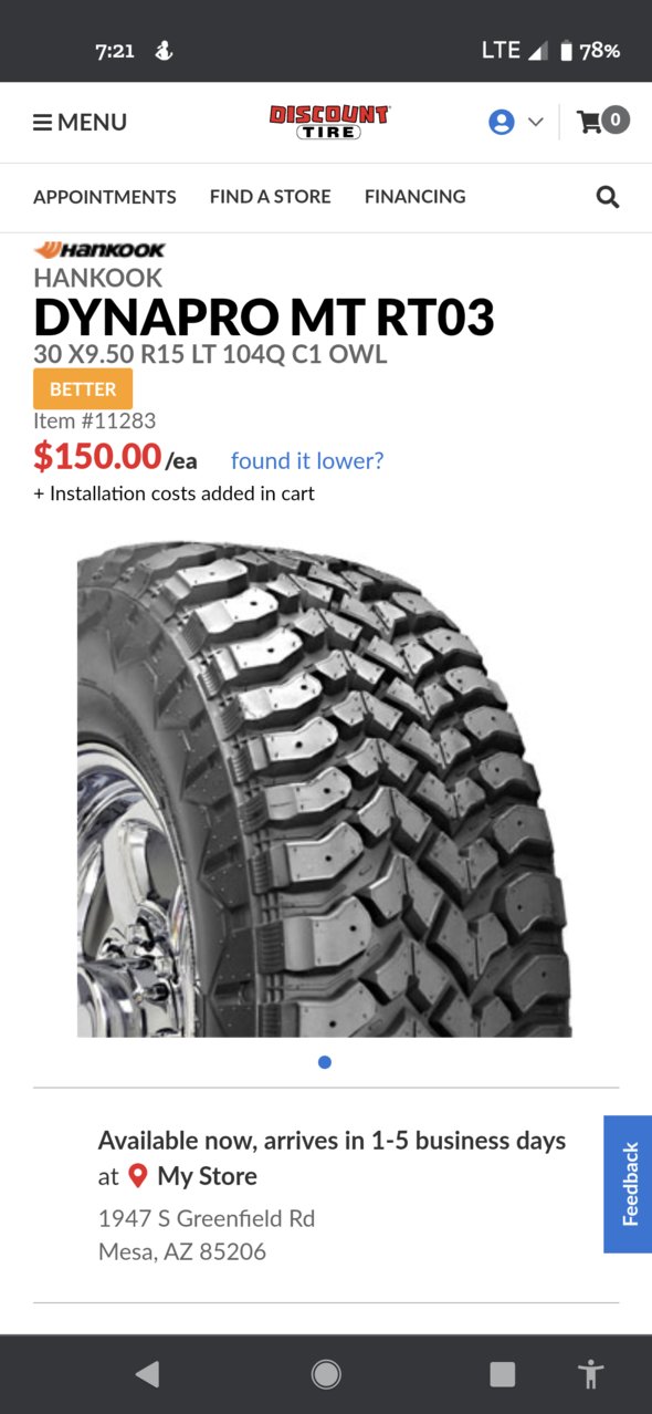

    Stock again- rip slug
    Why I asked, thank you. Looks like I might step down to 30x9.50 till next set. That wasn't even at bump, just ride height :/
    I think our hoods smash the fill area

    You can't just lower the mounting?
    Aren't you then left with the issue of it hitting the skid plate. I couldn't lower one much before it was just more vulnerable and the fan shroud wouldn't match up.

    I can see the appeal of a drop-in then from Cold Case.

    I had the new Tacoma version of the Koyo. It cracked. Not willing to try the 4Runner one because it’s cracking for people as well.
    Leaning towards these if I have to drop to 30x9.50

    What lift are you going to do on your front end? I had just the fabtech springs and uppers with 4x4 fenders and was able to run 31 inch bfg kos with only rub at full lock. When I added the lift spindles nothing rubbed. The Downey kit made it even better.

    i have v6 coils and the daystar spacer for 1.75- 2 inches in the front. No spindles sadly
