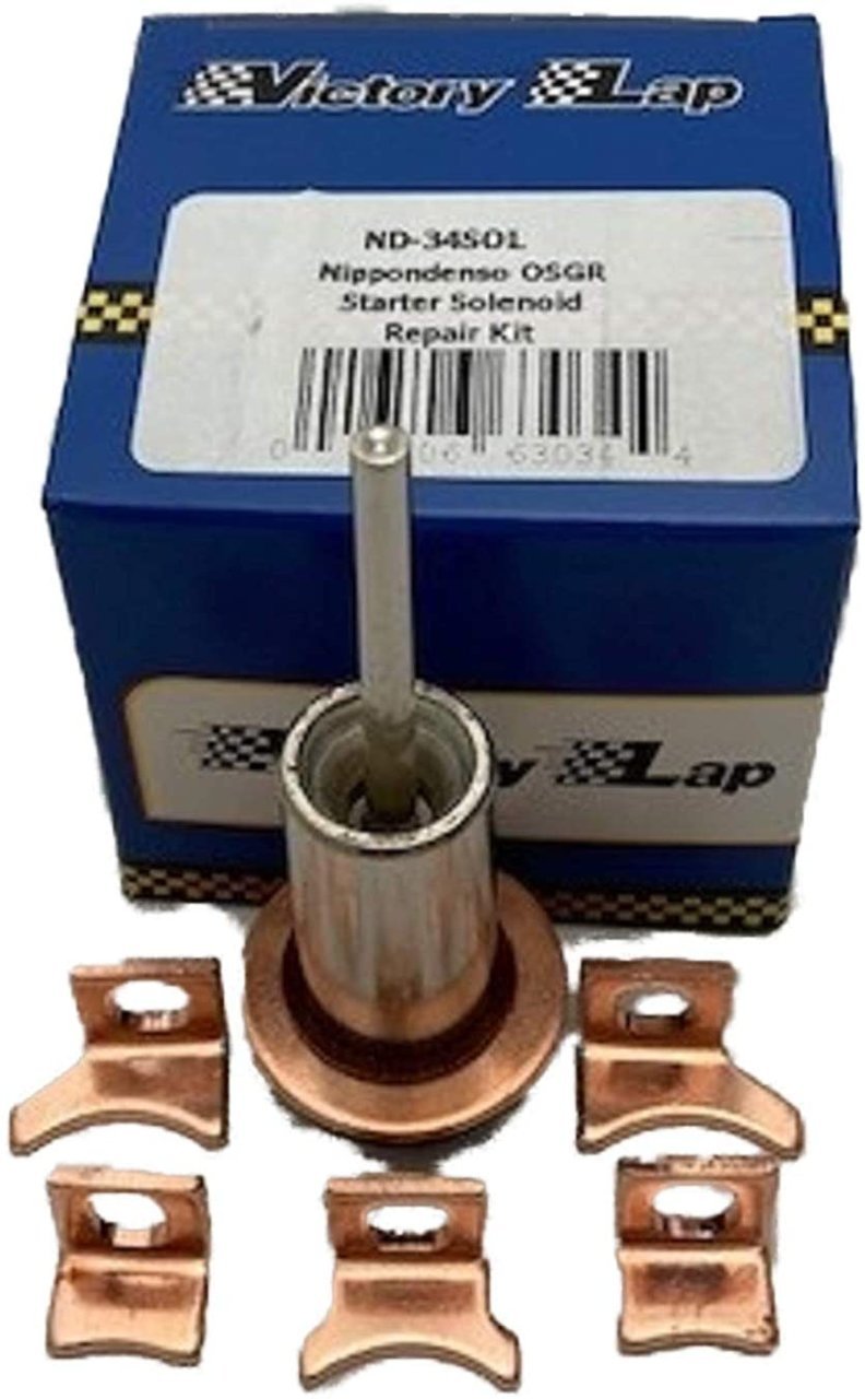

    Starter plunger and contacts ordered.
    Thinking I should buy another plunger and contacts in case I've got a 1.4kw starter, but doubt it since the 4R is a limited V6 and even has a rear heater.
    That'll be fun to do :burp:

    It's less Tacoma and more mod
    Starter size is determined by the presence of the Cold Weather Package. Rear heater is standard on a 4Runner

    Aware of the cold weather package; unfortunately I don't have the window sticker for the 4R even though I've got everything else (including the old salesman's business card).
    And using Partsouq and other sites using my vin doesn't yield what starter I've got.
    I tried looking at the label on the side but it's long gone.

    Does it have the insulated washer bottle or the water channeling window trim, those are good giveaways. Though they don't help if the starter has been replaced before by someone who didn't care.

    Not aware of any insulated washer bottle or window trim; interesting.
    I just looked at what I ordered last night and noticed it comes with contacts for both starters.
    Do you know if the plungers are the same for both models though?
    Now you got me wanting to check for what you posted.

    Plunger should be the same, the bendix has the same travel amount to engage the flywheel/flexplate

    Thank you for that.
    I want to pull out the starter, replace said items, and toss it back in.
    I left my replacement starter at the storage in Fresno as part of moving all my shit over :facepalm:
    Told myself I'd replace my thermostat and coolant, only to remember I left my new thermostat in Fresno as well :facepalm:

    Always good to do the contacts before they wear out, my 3RZ one used to stick on sometimes and you'd have to cycle the key to start a few times to get it loose.

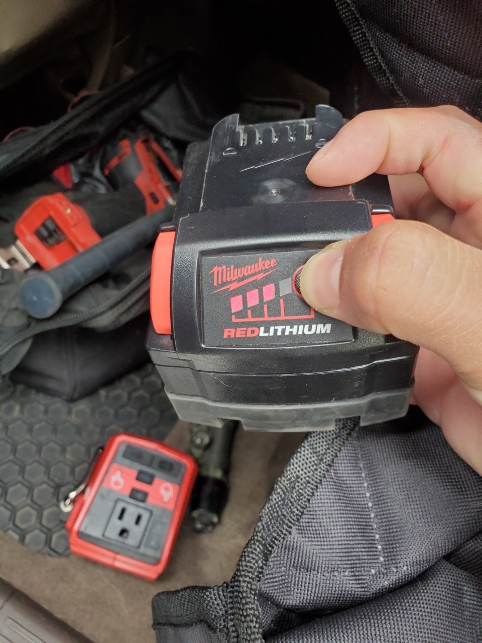

    Psst @Sperrunner @Kwikvette Do you know how long the M18 XC 5.0 batteries last? For example while breaking bolts free….my 1/2 impact kit is on the way, just wonderin if/how bad I might want a second battery.
  13. Jun 25, 2021 at 9:27 AM
    Kwikvette
    Feb 27, 2019
    #284735
    82,955
    Fresno County
    4 run, 2 don't
    Buy a second battery just because.
    But if it's any consolation, I haven't recharged my M18 5.0 battery since last year.
    I have since, pulled my tires off at least 2 times, spare 4 times now, and a few rear suspension parts.
    I checked my battery while camping since I have the Milwaukee inverter and it was still almost full.
    In fact, I'll check now....
    01x4[QUOTED] likes this.
