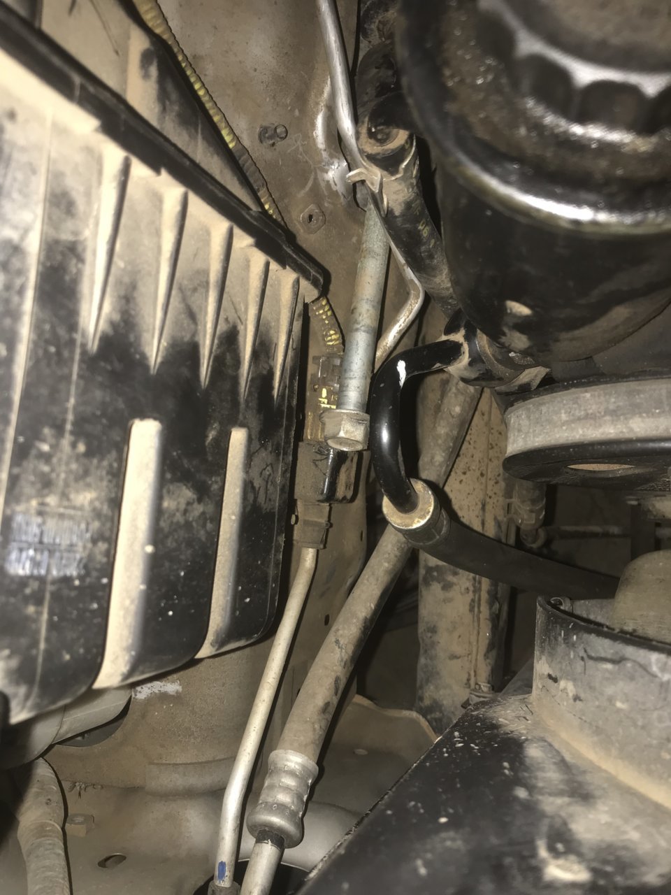

    The fuck is my uca bolt running into

    I'm an electrical idiot but I thought yellow was airbag/sensor related...

    I wonder how you get the thing off the fender

    I'm not sure but I'm about to do mine too so this is good timing. Looks like a tight squeeze. Is that connection spot clipped into the body?

    It looks bolted, not there’s nothing going through to the other, that I can see

    There’s another one the the other side of the truck too
    Hmm

    Yeah that's why I thought it was airbag related, driver/passenger.
    I had this one bookmarked, he pulled it on the drivers side to move it outta the way
    https://youtu.be/Y_ovdYY4oEc?t=423

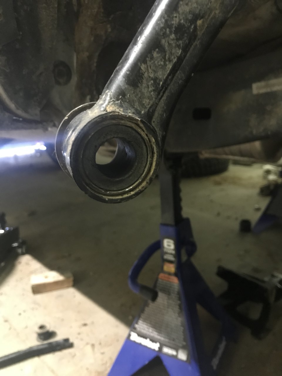

    Easiest way to get the uca bushings out

  17. Jun 26, 2021 at 5:44 PM

  20. Jun 26, 2021 at 5:57 PM
    6P4
    6P4 Well-Known Member
    Jan 31, 2021
    #354625
    4,127
    Colorado Springs
    98/2.7L/Regular Cab/4x4/5spd/Open diff
    Ways that I tried....
    1. Bottle jack. Didn't work for me because my bottle jack was too big (worked fine for LCA bushings, though).
    2. Use hole saw to carve out the rubber and then hacksaw to notch the sleeve so it can be peeled out. Didn't work for me because I couldn't keep my drill slow enough to keep the rubber from melting and bogging down.
    3. Use a shop press, version 1: Use the UCA bolt and whatever washers/sockets you can find to make a press adapter. The bolt goes through one bushing to press down on the other. This works if your arms are super clean--I used it to salvage fresh bushings from damaged arms--but it's easy to bend/break the bolt if the bushings are corroded (and they're almost certainly corroded). I do not recommend this approach.
    4. Use a shop press, version 2: Use a Harbor Freight bearing splitter (or similar) as a press adapter, as described in Timmah's video. This worked well--the hardest part is bending the flange to get the adapter in. Actually, the hardest part was swallowing my pride and buying the bearing splitter, but after that...
    With hand tools... #2 is your only option, as far as I know. It'll work with enough patience. You could torch the rubber out rather than cutting.
    EDIT: I'm assuming you're replacing them with OEM-style bushings. If you're using Energy Suspension bushings, you need to torch the rubber out and leave the OE sleeve in place.
