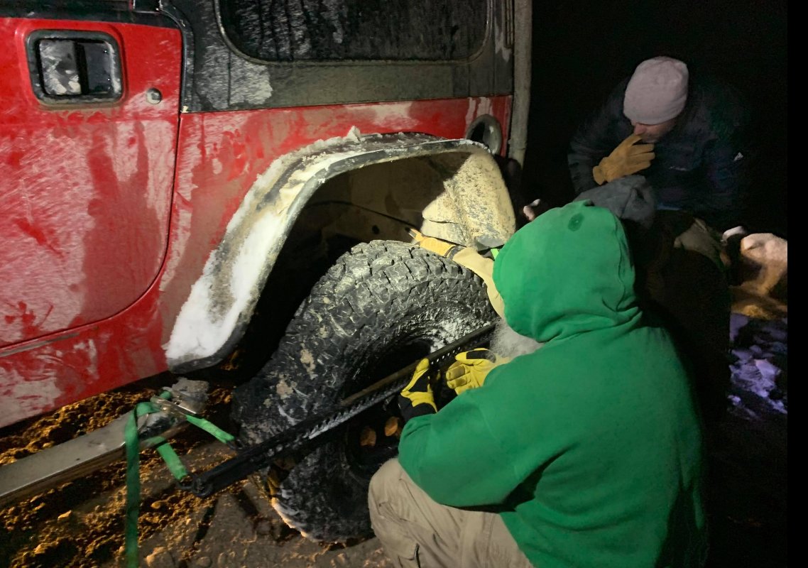

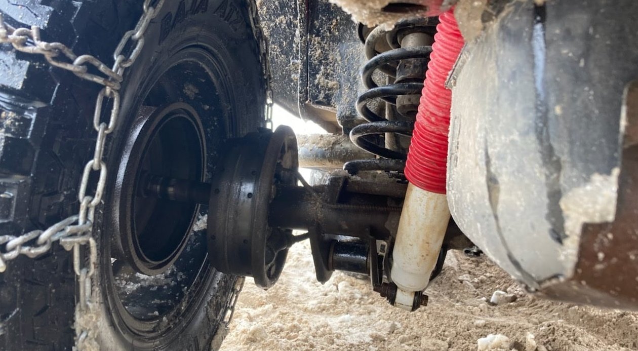

    Just put a 1’ body lift on the cab of the truck when to turn it around and do the back but the wheel was spinning freely and the tires did not move at all any ideas what the fuck happened. I think I jacked it to high while installing and broke something in the steering.

    Very common on jeeps with oversized tires. The rear axles are retained with a C clip that doesn't like the abuse.
    In highschool a buddy's XJ on 33s chucked an axle like that hitting a pothole
