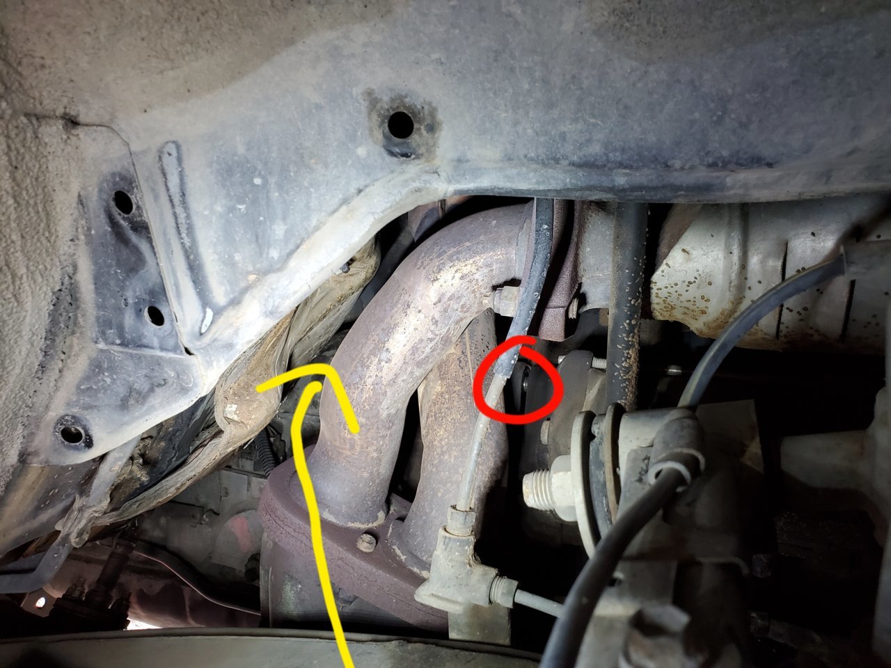

  12. Jun 30, 2021 at 12:32 PM
    Kwikvette
    Feb 27, 2019
    #284735
    80,586
    Fresno County
    4 run, 2 don't
    @Das it mang
    On a 2 wheel drive 3.4 its easy
    On a 4 wheel drive 3.4, its a whole different story
    I read on an auto it's even harder than it is on a manual
    Broke the bolt loose finally
    6 point 14mm to a swivel, to a 6" extension to a 12" extension to a 5" extension to another 5" extension to a 24" breaker bar

  14. Jun 30, 2021 at 12:38 PM
    Kwikvette
    Feb 27, 2019
    #284735
    80,586
    Fresno County
    4 run, 2 don't
    Zane and Jaxon are brave souls or have Dan sized hands if they went through the wheel well.
    The red shows the area the bolt is for the starter (top bolt).
    Yellow shows how little clearance there is just behind it; exhaust manifold is in the way not to mention a bracket in that area.
  15. Jun 30, 2021 at 12:44 PM
    Wulf
    Wulf no brain just damage
    Jan 30, 2015
    #147523
    61,496
    rock raisin
    I want to say I did it at one point with a basic 3/8 drive ratchet and wrench set but I have no idea how that could have happened based on that pic

  17. Jun 30, 2021 at 12:48 PM
    Kwikvette
    Feb 27, 2019
    #284735
    80,586
    Fresno County
    4 run, 2 don't
    Well you have a manual right? There's more clearance apparently.
    Now that I undid the last bolt, finding out I need to remove the upper part of my dipstick tube
