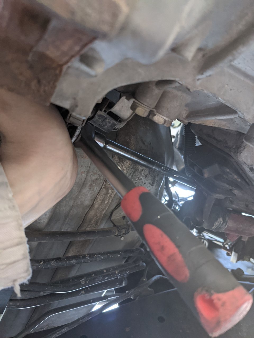

    In my infinite wisdom, I left my 1/4" drive socket set in storage.
    I have an extra 1/4" ratchet with me, but not an 8mm socket.
    Wrench it is :laughing:

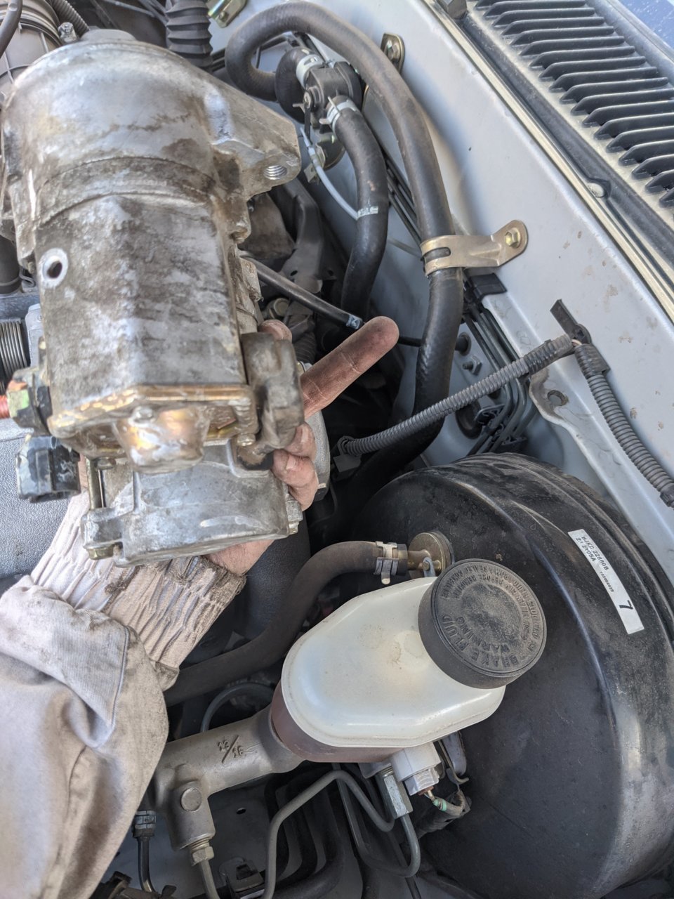

    @Kwikvette u doing it preventatively or did it start to not work on you? Just curious of signs when its needing new contacts

    When I would turn the key, it would simply click.
    It wouldn't try to turn over or anyting.
    Das it mang[QUOTED] likes this.

    fuckin funny, same exact symptoms i had when the alarm got disconnected. Guess i wasnt wrong at that time with my train of thought, thanks!!

    This is what happens over time

    Fucking a, starts right up now.

    @Speedytech7
    Thanks for confirming plungers being the same for both starters.
    Based on the size, and lack of insulation on the reservoir, it's safe to say I have a 1.4kw starter.
    That kit had plenty of contacts and I found the 2 that were a perfect fit.
