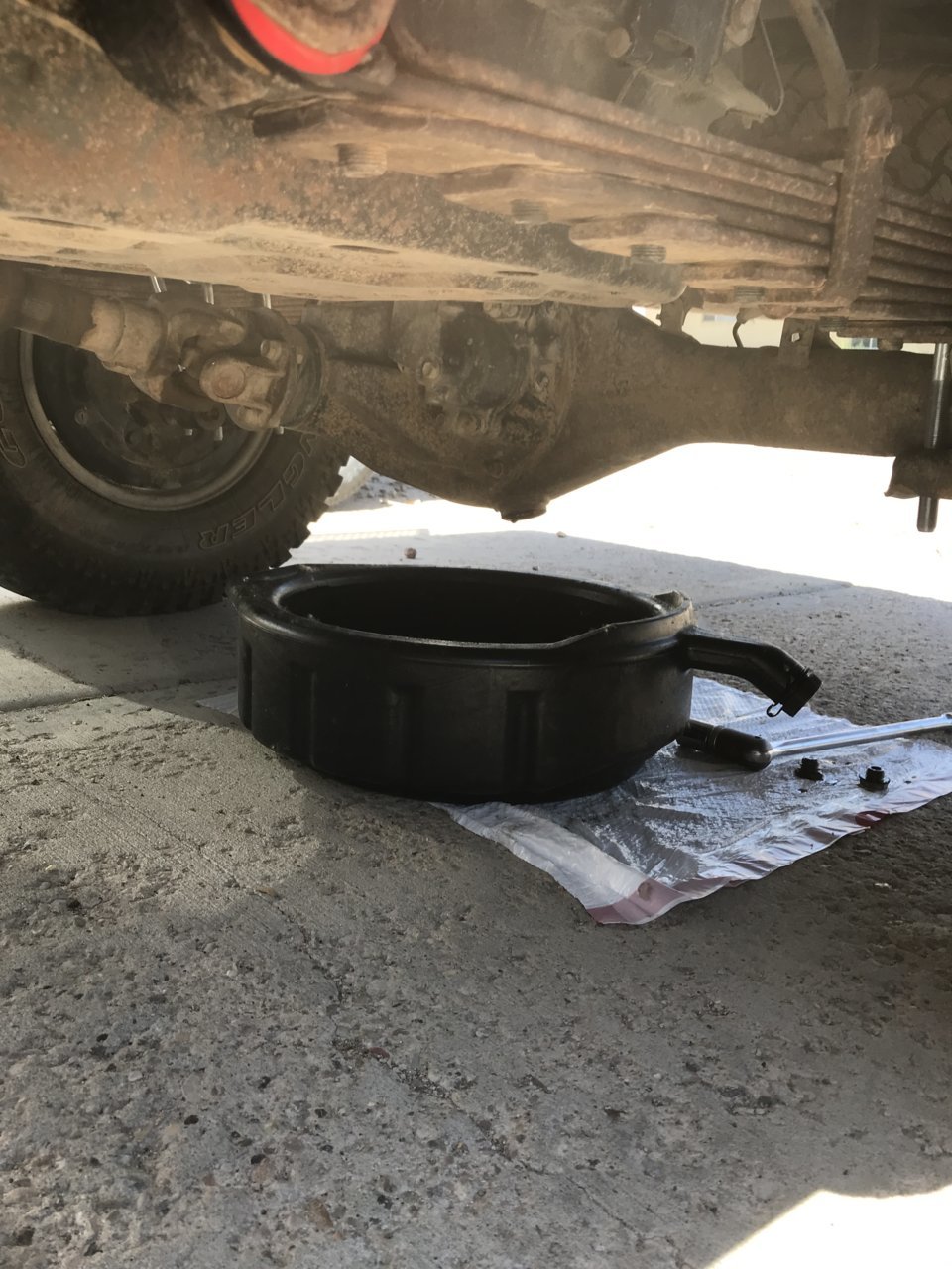

    Mines def 10mm for both but the T4R might be different
  2. Jul 2, 2021 at 10:20 AM
    Kwikvette
    Feb 27, 2019
    #284735
    81,709
    Fresno County
    4 run, 2 don't
    Year specific, not model.
    95.5 - 97 are 10mm and 12mm
    98 - 04 are 10mm

    4 quarts enough?

    More than enough for the front.
  9. Jul 2, 2021 at 10:42 AM
    eon_blue
    Mar 4, 2016
    #180213
    69,810
    Azusa, CA
    Yeah the front is like 1.8 qts or something like that. It's pretty small
    4 qts would be enough for front and rear or maybe just a hair under.

    I would hope I’d know that by now
    diff was pressurized, better order a breather

    do it, beats changing axle seals
