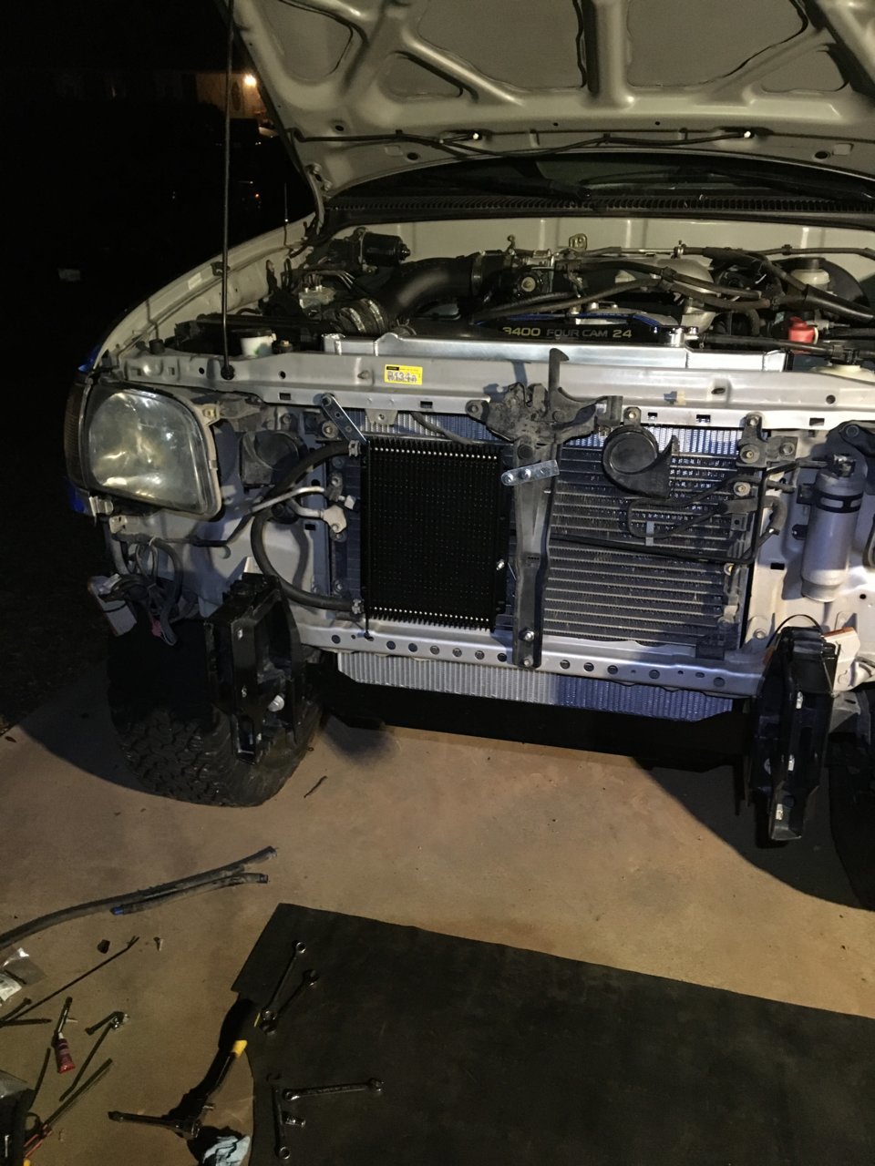

    Do you remember the diameter hoses and length you used for the transmission cooler to the feed/return lines coming from the tranny?
    Or which way did you route it?

    I used 3/8 transmission hose which is a bit tight. I think 8-10 feet is what most write-ups recommend so you can run it through that hole in the core support and from the radiator.

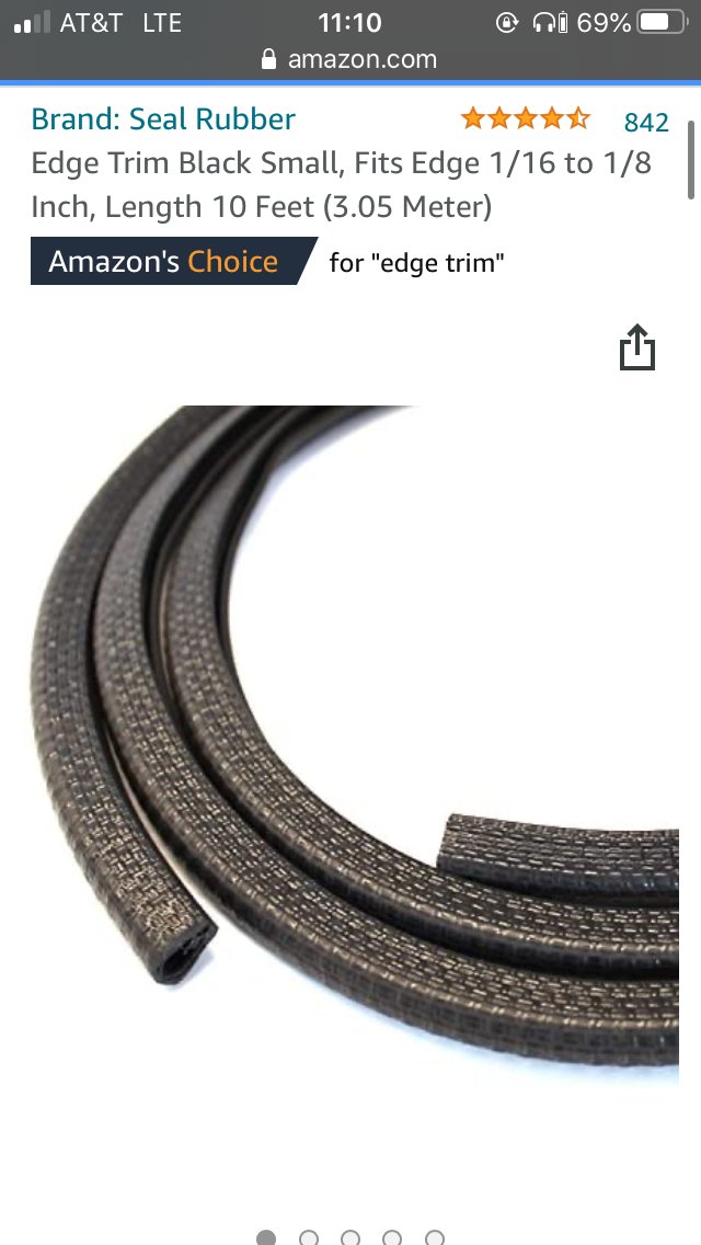

    I had to run an in-line thermostat with no internal rad trans cooler. So I just bought 25 feet for peace of mind. I also used some rubber trim to line that hole in the core support and protect the hoses.
