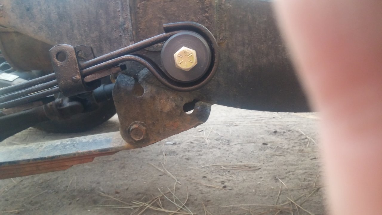

    Maybe weld them to the frame 1st then notch the over shell to fit?
    How much for a set of thows leaf hangers. I need to do this my deavers. They are longer then stock for a 97.

    It's less Tacoma and more mod
    They have to get set into the frame about 1". So I have to cut a chunk out. They're extra stout for frenching. They're also way too wide for Toyota leafs, I think they make ones for Toyota leafs though. Check RuffStuff specialties

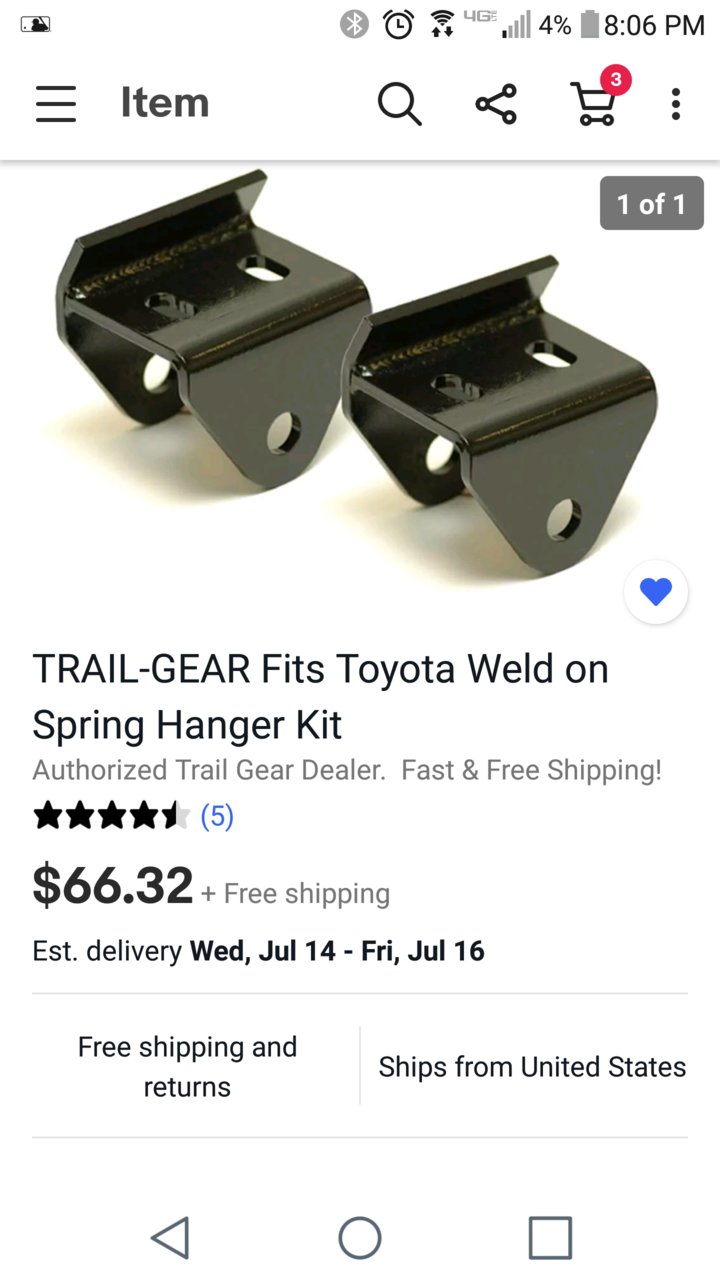

    I was looking at the trail gear kit.

    Those should work afaik rear leaves have been the same width since 85 or so. You could cut yours off and move them too
    I bought a set of these before I decided to do 63s and they're fairly stout. 3/16, they're welded together though, not brake bent

    I was on the fence about welding on gussets to the stock ones with new mounting holes.
    That's incredibly hard to do, I just removed some and to get them off without spending years, you need to kill em

    Grow up poor waste nothing :luvya:
    I'd be checking if ruffstuff or Barnes has some weld ready hangars though. Time is more valuable now

    That angle on the side not cause fitment problems?
    It centers em on the thinner pickup frames. You have to shave it a tiny bit to get center on a taco frame
