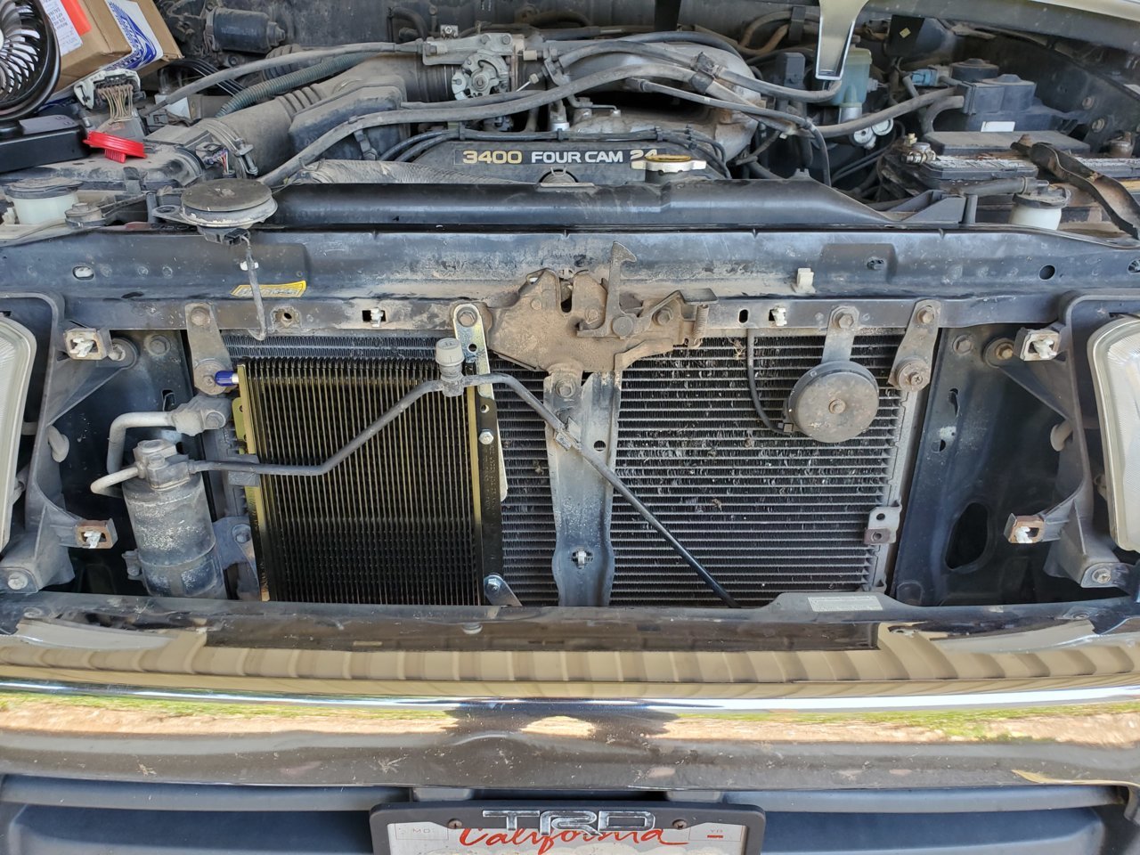

  17. Jul 9, 2021 at 1:28 PM
    Kwikvette
    Feb 27, 2019
    #284735
    82,959
    Fresno County
    4 run, 2 don't
    Ok now it's secure.
    A lot of stock holes to use which makes this easy.
    And the coolant I drained
    @Speedytech7
    @04Pre_Runner
    Want your advice and the "right way" to run these lines.
    The line I'm holding with my left hand (its passenger side) is my feed line?
    If so, does that go to my aux cooler top inlet?
    Then I take it I'd run a line from the bottom of the aux cooler out to the passenger side inlet of the radiator?
    I guess I'm just not sure of the direction of flow, and which line feeds and which line receives.
    CS_AR likes this.
  18. Jul 9, 2021 at 1:31 PM
    Speedytech7
    Feb 20, 2014
    #123587
    58,587
    FCQM+VG Cheney, Washington
    It's less Tacoma and more mod
    Output from trans to new cooler, new cooler to rad, rad to trans return.
    Kwikvette[QUOTED] likes this.
  19. Jul 9, 2021 at 1:32 PM
    Kwikvette
    Feb 27, 2019
    #284735
    82,959
    Fresno County
    4 run, 2 don't
    Yep so just what I was thinking.
    Aux cooler receives first, then out to radiator.
    But the line I'm holding, that's the right one to feed towards the aux cooler right?
  20. Jul 9, 2021 at 1:35 PM
    Speedytech7
    Feb 20, 2014
    #123587
    58,587
    I'm not sure, never owned a 4r or taco with an auto. The ones on my LC are different I'd assume. Should be able to follow it from the trans though
