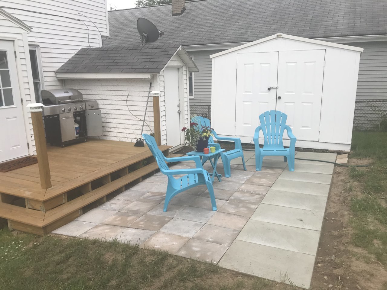

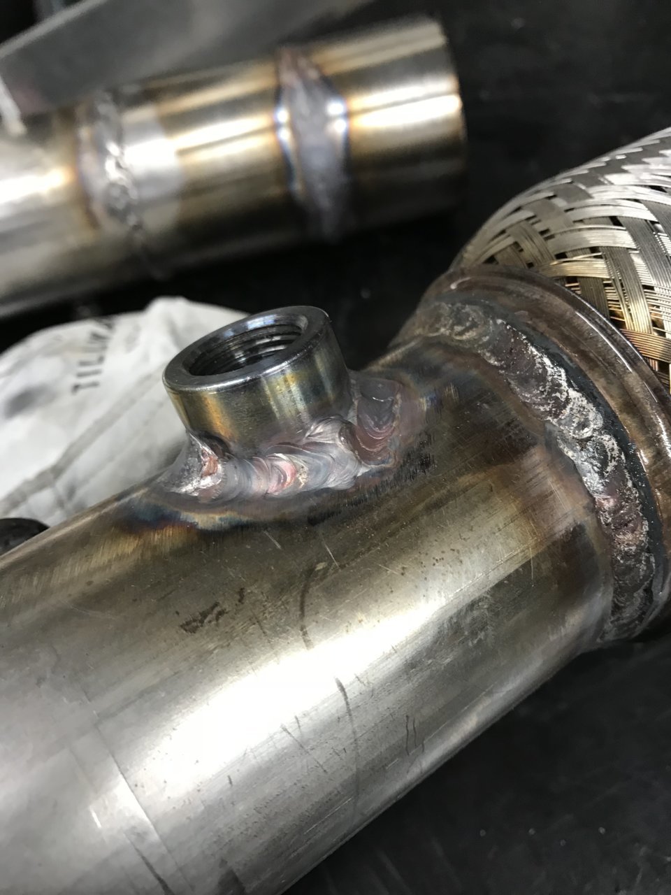

    And welded a new o2 bung for my down pipe now to find a wideband that will thread in instead of using those dumb flanges

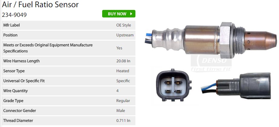

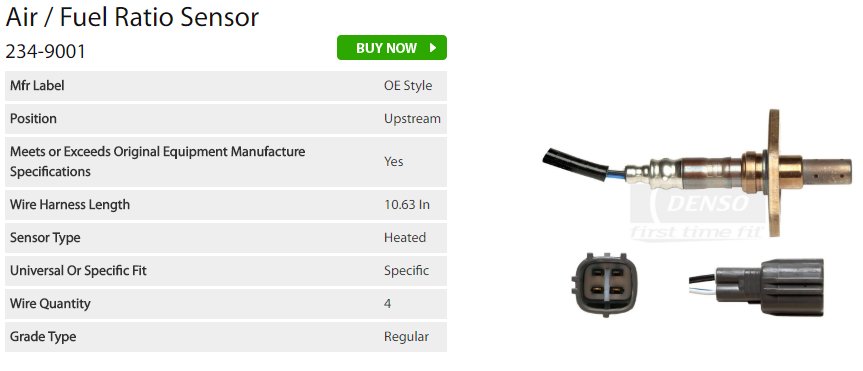

    Okay so I did a bit of research to make sure yours was an A/F sensor stock and is most certainly is. Then I looked for a similar vehicle (4 cyl (~2-3L) around the same date of mfg and toyota of course) that uses threaded sensors. Looks like an A/F sensor from a 4cyl 04 Camry would work. The biggest differences within a model range usually come from wiring length and connectors used, the sensor itself is pretty similar across all models. They are both A/F sensors from a similar model range "234-90xx", I'd put money on it working perfectly, even the pinout/connectors are the same
    Here's your sensor...
    Here is the one from the Camry that I'm 90% sure would be PnP...
