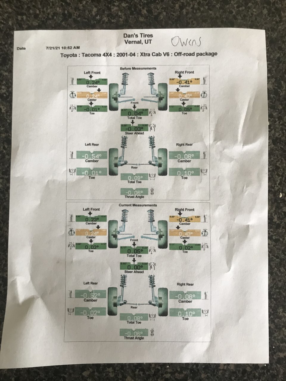

    They say this is as close as they can get

    No and no
    stock with icons and like 1.5” of lift

    Uh...they didn't change shit except the toe. Actually it doesn't look like they changed much at all, but I guess that's as close as they could get it the last time.
    Why they said it was good the time before is weird to me, probably why they didn't give you a print out lol

    You might be in the same boat as me, something slightly bent. I can't get mine aligned evenly side to side either. Replaced every bushing up front. Replacing my lower arms next once I get around to it. I'm able to make it work with my spc's adjustment though

    Yea, they could get much to move from the original alignment to now.
    They rotated the tires, see what happens the next couple of weeks, maybe try a different shop.

    At least try another so you can rule out the shop I guess. I'm a little suspicious why they called that good the first time and 'forgot' to give you an alignment sheet lulz
    But they might be getting it as close as they can and there's something else amiss. Another shop might be able to narrow it down. Trying to chase alignment gremlins blows. I know all too well

    it’s be funny if they totally realigned it, reset the computer to the new numbers and then changed it a tiny bit

    Classic "Toe-n-go" alignment

    @JKO1998 does your truck pull at all? Or is it just the bad tire wear?

    Wanders everywhere
