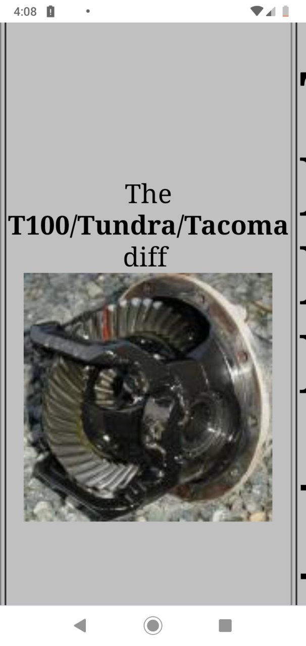

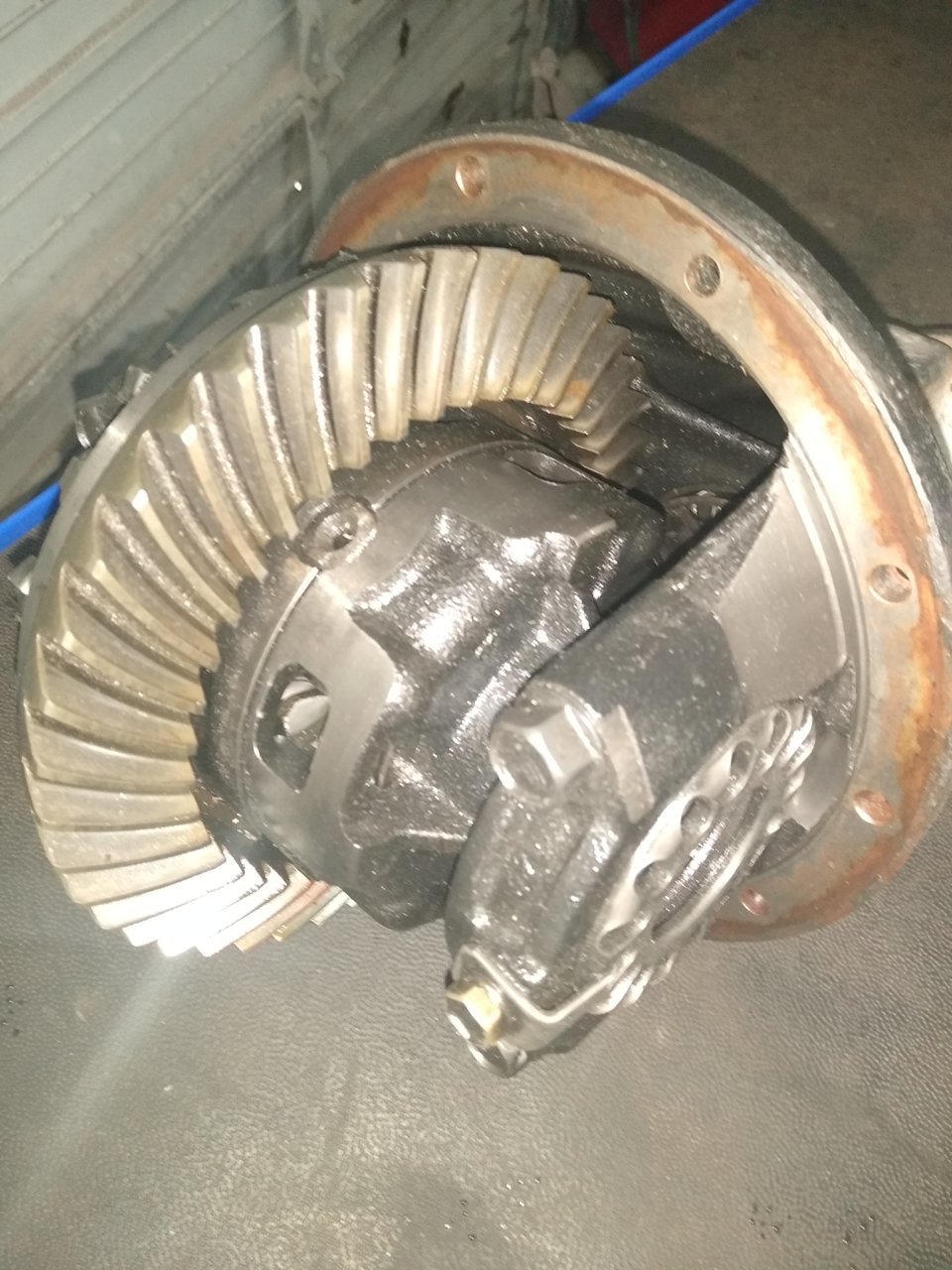

    They are in most ways, different
    14mm nuts holding it on vs 12mm, bearing truss vs caps, 2 pinion vs 4 pinion ones called an 8" the other an 8.4"

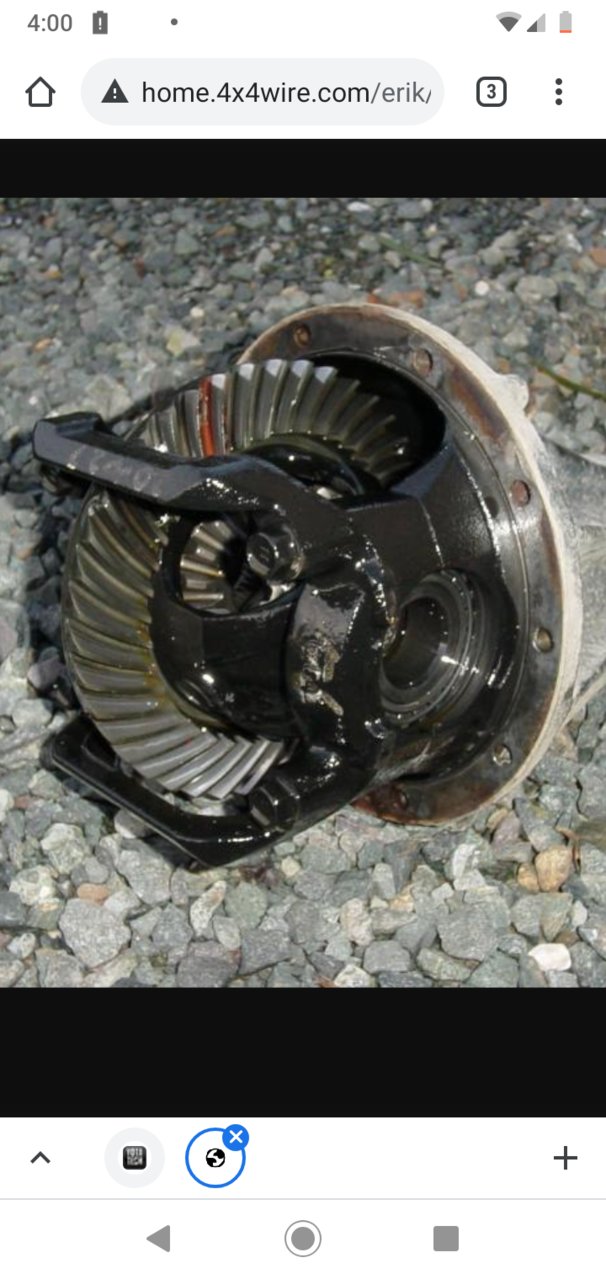

    Is that a 1st gen diff?
    Cause google says no
    Kwikvette likes this.

    1st gen tundras use the same diff as 1st gen tacomas

    They do use the same diff as the non TRD 6lugs the 8.4

    Look up V6/turbo diff it is what you have
    the 8" can be open or closed carrier (V6/turbo). The 8.4" is only open style carrier

    All the pictures I’m seeing make the tundra diff look completely different than 1st gens
