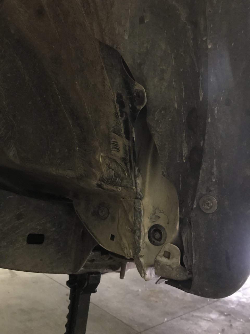

  9. Jul 31, 2021 at 8:30 AM
    JKO1998
    JKO1998 Well-Known Member
    Jun 2, 2015
    #156578
    53,014
    Utah
    I’d change that for sure

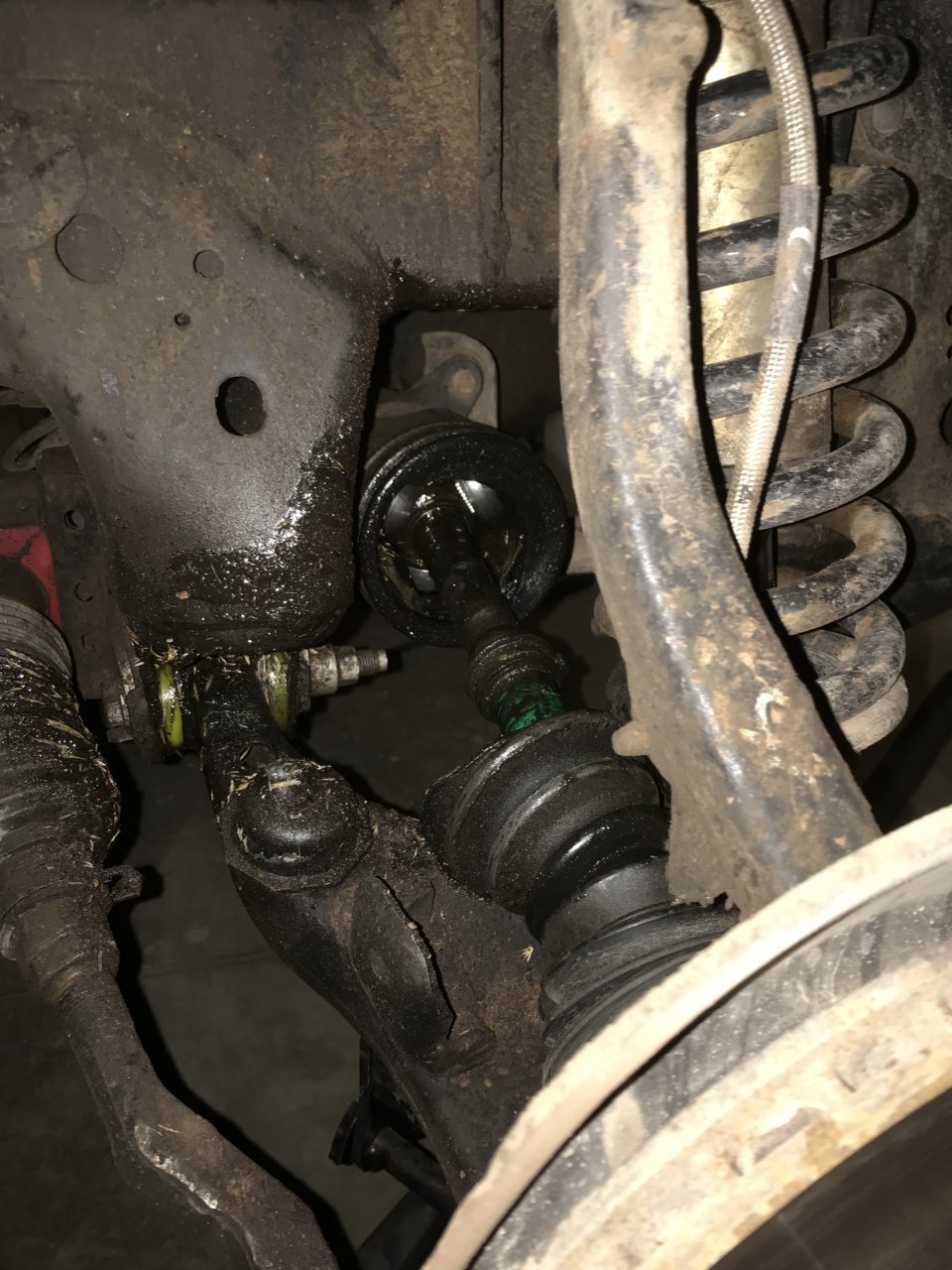

  10. Jul 31, 2021 at 9:24 AM
    JKO1998
    Jun 2, 2015
    #156578
    53,014
    Utah
    Bye bye clean door hinge

  17. Jul 31, 2021 at 10:40 AM
    JKO1998
    Jun 2, 2015
    #156578
    53,014
    Utah
    Y’all into those bootless cv axles?
    eon_blue and Kwikvette like this.
