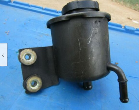

    I'm still leaning towards the 97-2000 Lexus LS400 one for the 4Runner. Will take a little modification of the mounting brackets to make work but should be doable. Something I will address once the Subie is being daylied.

    That Lexus pump looks good. I wish I still had one of these old Q45 reservoirs laying around. The tank was large and the cap fits tight.
    There was a multi-layer wire mesh screen in the bottom that could be easily cleaned and reused. The thing I liked most about it was the wide cap mouth.
    I could insert two tubes inside the reservoir to evacuate and fill while the pump was running to flush the system quickly without removing any hoses.

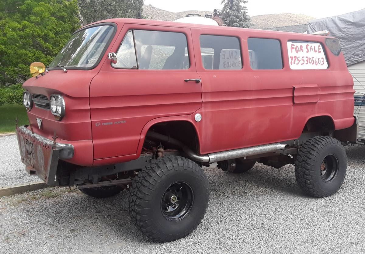

    Get rid of that stupid zombie hunter crap and I'd drive it as a daily:anonymous:

    That looks good. Are there fittings to convert the threaded fittings to work with standard PS clamped hose size fittings?

    yes, I have 90 degree fittings that thread on to the reservoir and provide a barb for the hose to push on

    This reservoir is for LC 75 80 100 1HZ 1HD series. I'm sure this is what people running a 105 in Australia use for real off-roading.
