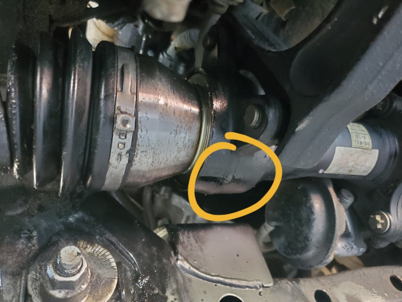

    See, if you look at the first picture, you can see no oil where the CV axle seal mates with the diff tube.
    So I'm hoping it's just residual as like you said, I use the proper tools and even measured the seal seating depth (I hit like 5.6mm versus the FSM's 5.5mm, and made sure it was even on 4 sides).
    You can see how clean the rest of the components are, because I blasted degreaser everywhere and pressure washed underneath. I didn't realize my diff tube still had a sticker on it until I cleaned it :cookiemonster:

    Hoping so Todd as I just did it this last Saturday.
    Tomorrow I'll be in normal clothes again so I'll check before I go putting on that heavy ass skid back on :violent:

    @eon_blue
    Dripping from where the CV axle meets the diff and running down to the diff tube...

    yep that's the seal or just leftovers, hopefully just leftovers. Exactly how mine looks but it's been a constant slow drip for months
