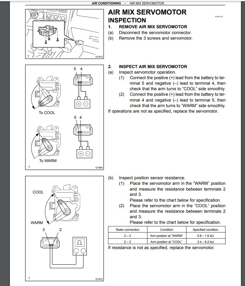

    Anyone ever replaced the blender door on their temp control unit? Mine keeps going back and forth without any input on the temp gauge.

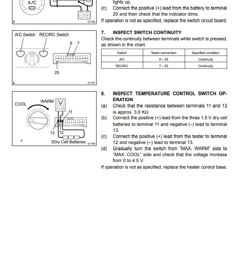

  3. Aug 31, 2021 at 10:00 AM
    Black DOG Lila
    Black DOG Lila Well-Known Member
    Jun 14, 2019
    #296344
    9,116
    Virginia
    2003 Tacoma SR5 2.7 5 speed 4WD
    Stock. EZ pass.Dump pass.Inspection sticker.Convict printed lic.plates.FG cap.
    Tacotruck7[QUOTED] and Abeyancer like this.

    You’re the man!
