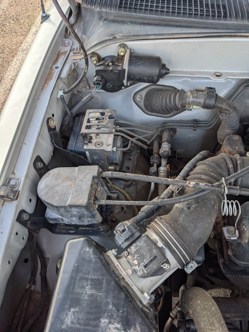

    Do i even have abs? The light is on

    If you have it it would be in the top left passenger side of the engine bay.. got a bunch of hard metal brake lines that come into it.

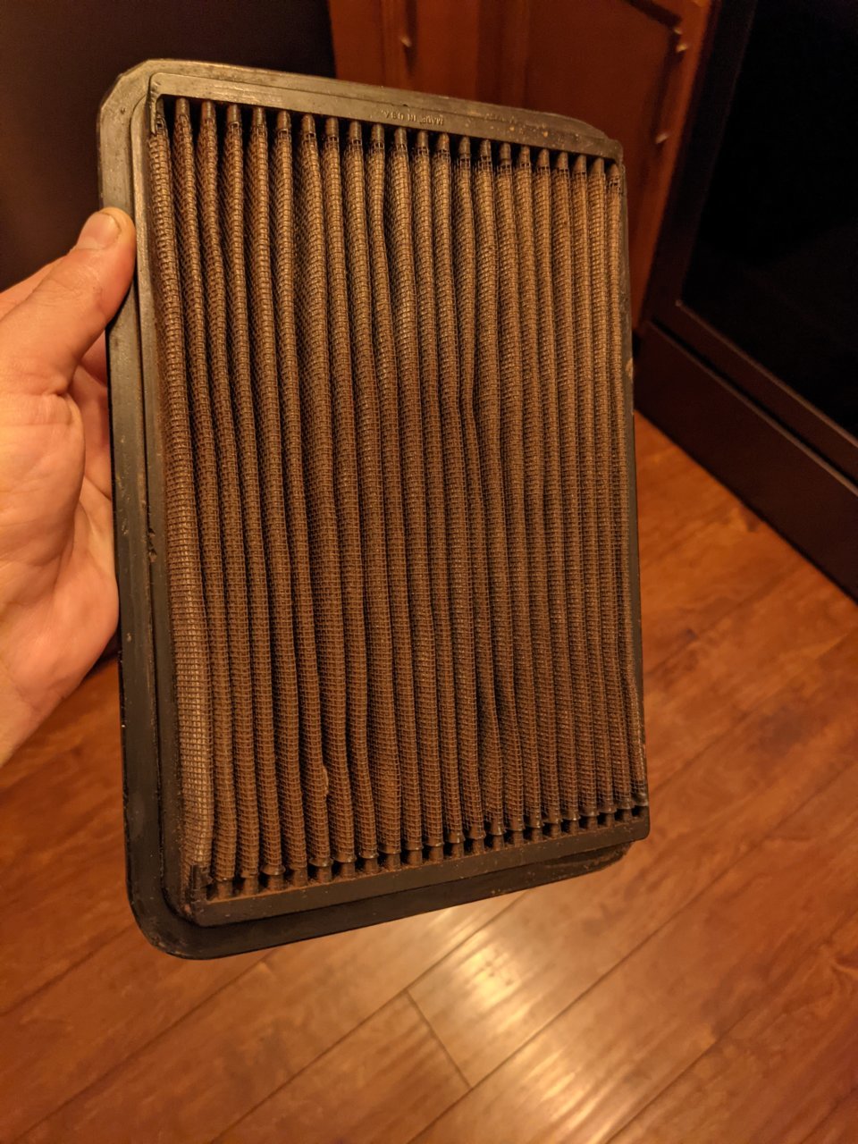

    Guess im swinging by wallyworld for a paper filter to use for this trip. I shoulda cleaned this last night but i was exhausted.
    Evidence why i needed the fender liner lol

    Dis it??

    Those look like Brake lines to me

    That is ABS module :thumbsup:

    Yep. Also If you've ever had your foot on the brake while going over a bumpy section of road/trail and felt the pedal make a weird pulsing/vibrating motion on its own - that's ABS kicking in. Makes a weird grinding noise too

    Oh shit, ive had the grind thats it. Just thought it was worn brakes lol. Should i worry about taking this trip having done nothing about the light being on now? I looked up how to find the codes and seems to be a pain

    Some simple scan tools can't pull up ABS codes, etc.

    Probably just means you can't rely on abs working properly but it's not the end of the world. Lot of people drive around without abs and some even remove it because it's kind of annoying on the trail.
