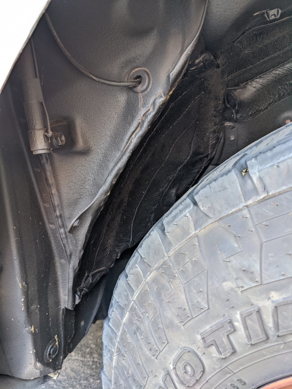

    :notsure::notsure::notsure:
    Came up right after i undercoated the wells. Thought i covered everything up enough, maybe coincidence? Never blew getting wet in mud
