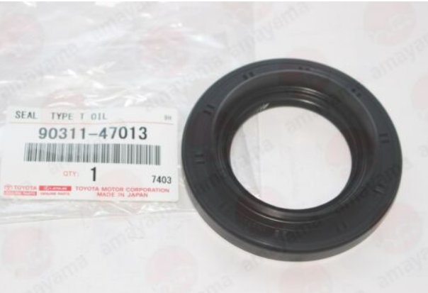

    Everything but the driveshaft. B03A - 410
    I'm getting ready to pull the driver-side CV axle to replace the seal. I'm going to take @Speedytech7 suggestion and avoid breaking the axle splines loose -- and not f*king with preload, spring clips, and all that by releasing the ball joints. I have a new OEM seal. Salute OEM.
    Why did this seal only last one year?
    Taking a closer look at this seal, it does have an inner and outer seal and a lip. The outer lip should keep dust out of the inner seal areas.
    But the two inner and outer seals are different sizes. The inner seal has a slightly smaller ID. The outer seal has a slightly larger ID. The outer lip is even larger.
    The reason I think the seal had such a short life is mud collected between the outer seal (the one with the slightly larger ID) and the inner seal that should be keeping mud, water, and dust out of the front differential. I'm disappointed in a design that doesn't use the same size seal for both inner and outer when the CV axle shaft that the seal rides on is the same size.

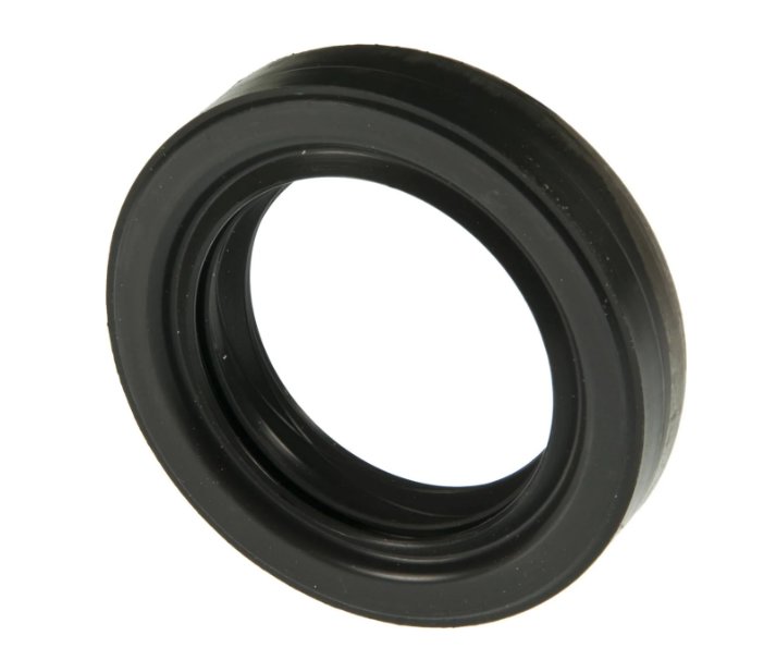

    It seems strange. So I go look at a Nissan seal from National and both inner and outer are the same ID. The CV axle dust cover buts up against the outer seal.
    Having both seals the same size appears to keep mud, water, and dirt out at the first layer. The second layer provides another layer of protection and I think is designed to keep the lubricant inside the front diff. They call it the double seal lip approach.
    It looks to me like that as long as I continue to do mud crossings, mud will collect in between the outer seal and the inner seal and cause the seal to wear.
    Let me take the damn thing apart and see if this is the case. I'm not crazy about mud crossings. But they are a regular occurrence here.
    Nissan seal - outer rim and inner appear to be the same size.

    Oh no way, you guys use the same cv axle seal?
    That part number correlates with the passenger side for us Tacoma/4Runner guys.
    CS_AR[QUOTED] and eon_blue like this.

    Yeah I remember when looking up the part number that it also fit Landcruisers, and 2nd gen Tacomas too iirc
