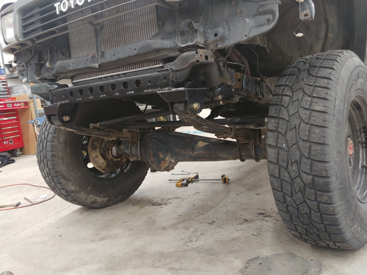

    It's less Tacoma and more mod

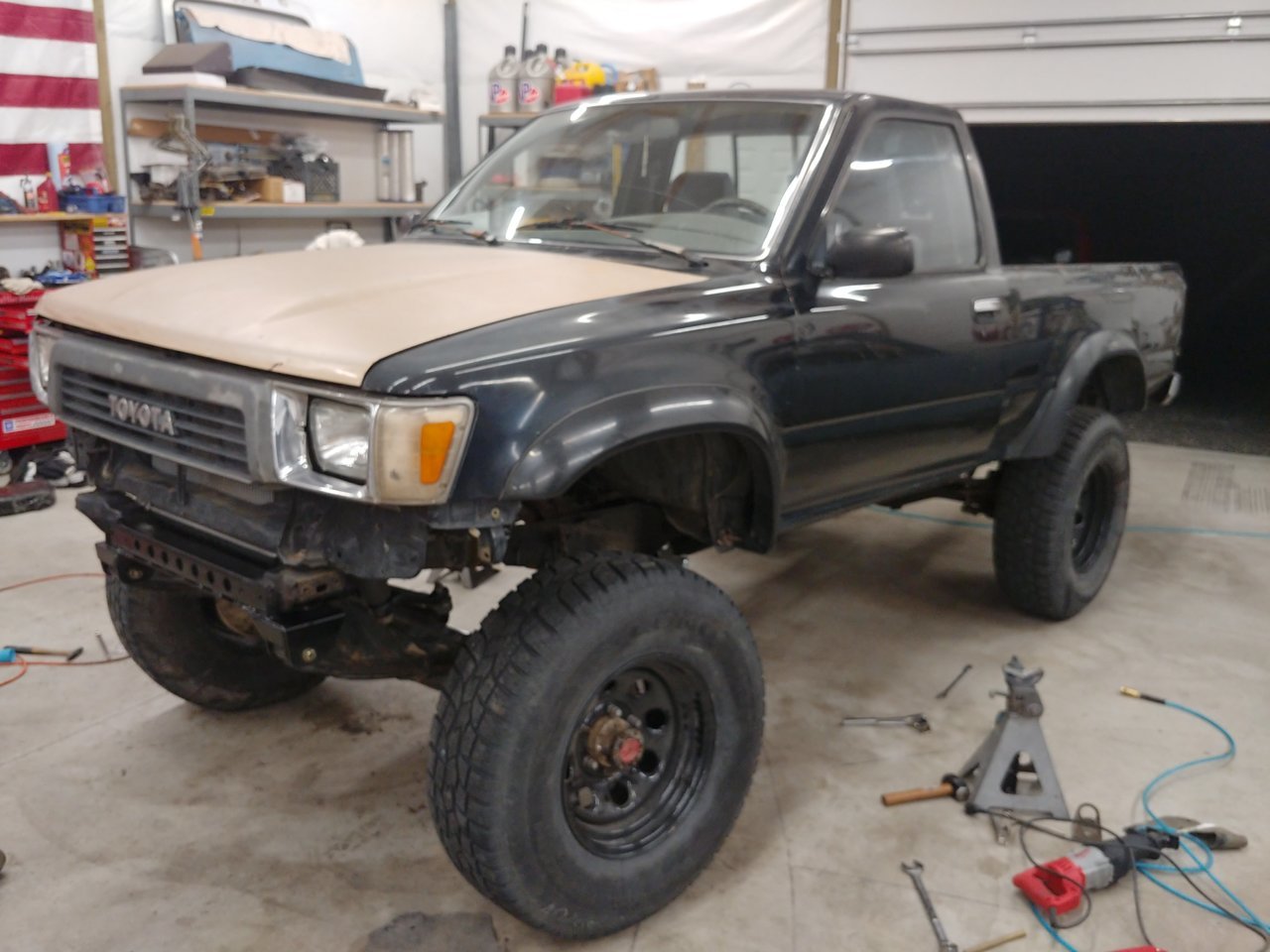

    Steering box? Yes, with a trail gear drop pitman with FJ80 balljoint hole.

    Yee haw :D you guys must have been cruising. Any hangups?
    I'm jealous of how easy the 3rd gen pickups and 2nd gen 4 runners are compared to anything after 95.5

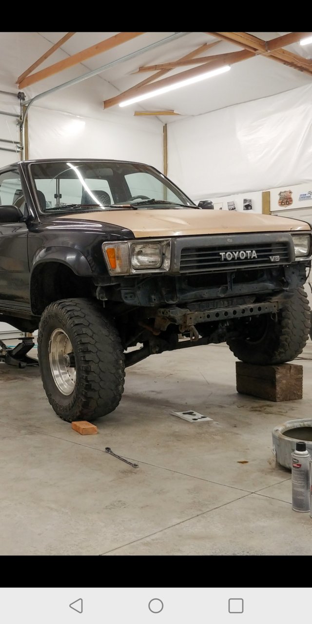

    Pretty much the only thing that consistently gave us trouble was that the plasma cutter kept deciding it didn't want to work. But it's pretty easy. Everything came apart and all the new stuff just fit right in. Only thing we haven't done is brakes but that's because I forgot to bring the flare tool. Oh and for some reason the third gen frame is like triple wall where you're supposed to put the shackle hanger and no one mentions that so it's very hard to cut.
