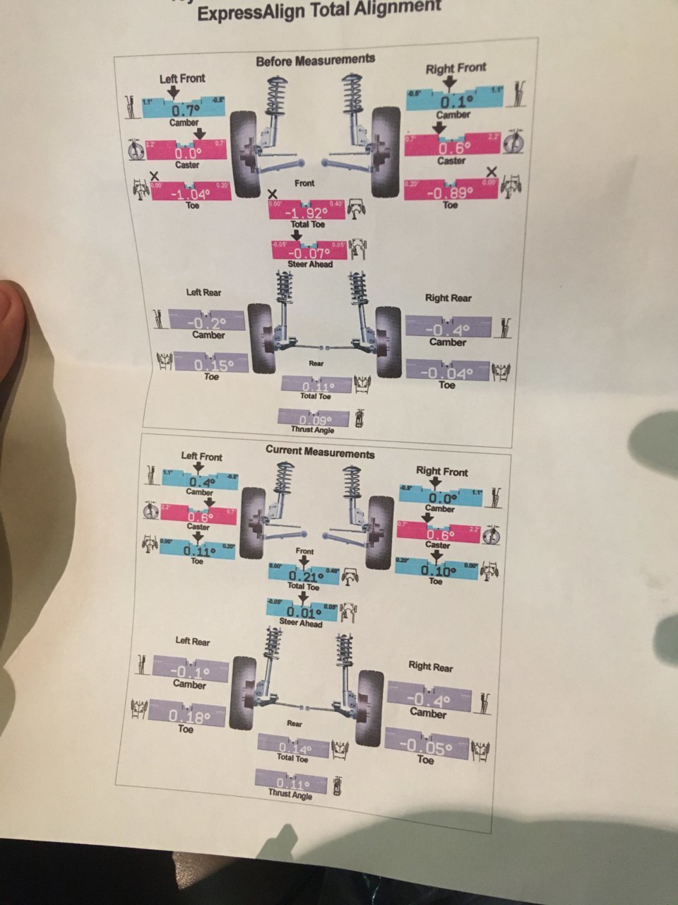

    Local off-road shop recommended the best alignment place in town... I've spent $400 over the last few months trying to get my 99 aligned. This place did it first try no questions asked.
    Still a ton of play in the wheel with brand new tie rods, rack, and poly bushings. Looks like the steering column is going to need some tack welds.

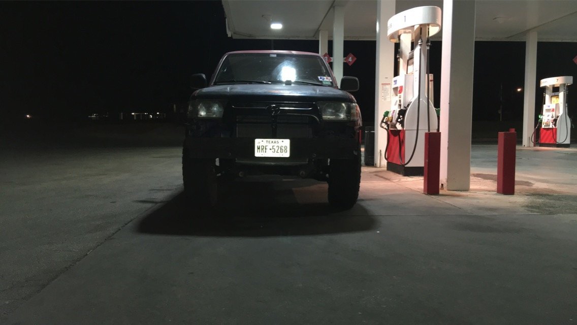

    Spoke too soon. Jumped on the highway and instantly knew I was driving on the edge of my tires. This truck is running the upper and lower control arms my 04 came with, new tie rods, and an OEM reman steering rack. Not 100% sure what’s going on but I guess I’ll take the 1” spacer on the front off.

    I’m starting to think it’s the truck. No way did 4 alignment places get it this wrong… a bent frame wouldn’t even cause this. So I’m stumped.

    I wasted a Saturday and $89 not too long ago trying to get my 4runner and taco aligned the same day. Long story short, LCA bushings and/or steering rack shot meant alignment not possible. Yours good?
    Noticed my brand new tires on the runner are already wearing badly on the outsides, prompting me to take care of this now.

    Lower control arms bushings have under 10K miles. Uppers have 110K miles on the arm/bushing and are off my 04. I’ve seen trucks with 250K+ align perfectly with the stock upper arm bushings. So I’m doubtful that has anything to do with it. Especially since the bushings aren’t collapsed or showing extreme wear.
