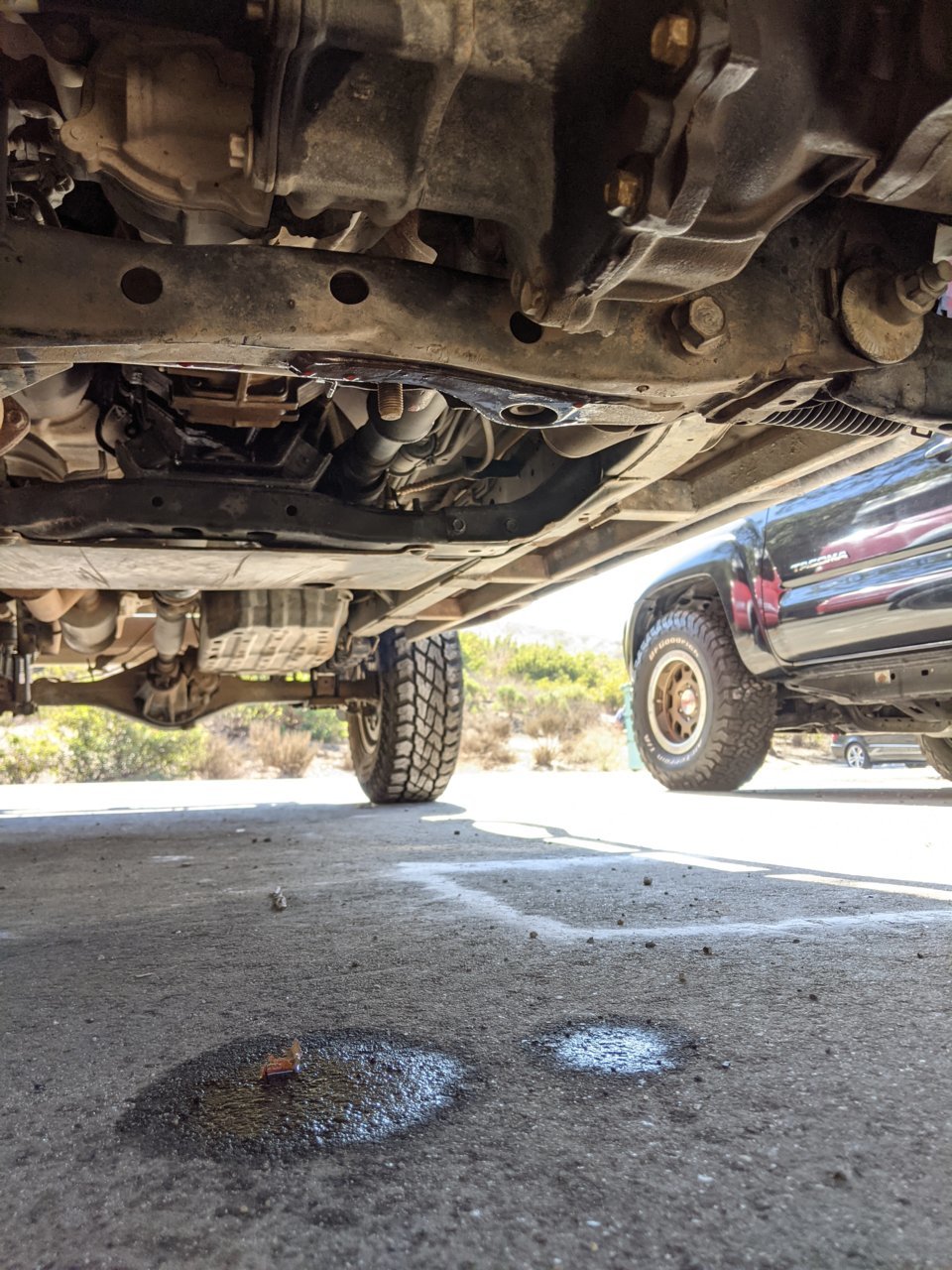

  6. Sep 19, 2021 at 10:36 AM
    eon_blue
    Mar 4, 2016
    #180213
    69,869
    Azusa, CA
    So remember that little coolant leak I mentioned last week...
    Yeah
    Gonna have to get this taken care of asap. Almost out in the reservoir so going to have to hit up a dealership on the way home from camping. Maybe see if the store here has some distilled water
  7. Sep 19, 2021 at 10:43 AM
    Kwikvette
    Feb 27, 2019
    #284735
    81,927
    Fresno County
    4 run, 2 don't
    Thermostat housing area, or waterpump area soaked?
  8. Sep 19, 2021 at 10:45 AM
    eon_blue
    Mar 4, 2016
    #180213
    69,869
    Azusa, CA
    Can't see any signs of where it's coming from other than it's gotta be the back of the block, nothing wet up front

  9. Sep 19, 2021 at 10:49 AM
    Kwikvette
    Feb 27, 2019
    #284735
    81,927
    Fresno County
    4 run, 2 don't
    Hmm
    Under/rear of the blower?
    Sucks you've got a leak, maybe we can try to spot the issue this coming Sunday.

  10. Sep 19, 2021 at 10:54 AM
    Wulf
    Wulf no brain just damage
    Jan 30, 2015
    #147523
    62,006
    rock raisin
    Heater hoses on the firewall?
    Hopefully it's not a HG or cracked head :(
  11. Sep 19, 2021 at 10:58 AM
    Kwikvette
    Feb 27, 2019
    #284735
    81,927
    Fresno County
    4 run, 2 don't
    Right, the valve on the firewall.
    Forgot about that thing.
    04Pre_Runner and Wulf[QUOTED] like this.
  12. Sep 19, 2021 at 11:01 AM
    Tour991
    Tour991 Supplier of used parts
    Nov 24, 2011
    #67616
    10,902
    James
    South Reno/Tahoe
    97 2/4wd, 2014 DCLB 4x4, 99 T4R Limited (sold) 2024 4runner TRD Pro
    Did you check the lines going in and out of the heater core?
    Wulf likes this.

  15. Sep 19, 2021 at 11:34 AM
    Empty_Lord
    Empty_Lord Toyotaholic
    Mar 13, 2016
    #181186
    28,298
    Dan
    Northwest Indiana/Chicagoland
    Coolant bypass pipe under the intake manifold. It’ll look like it’s leaking from the bellhousing.
  16. Sep 19, 2021 at 11:36 AM
    Tour991
    Nov 24, 2011
    #67616
    10,902
    James
    South Reno/Tahoe
    That's not going to be a fun fix.
    Wulf likes this.
  17. Sep 19, 2021 at 11:37 AM
    Empty_Lord
    Mar 13, 2016
    #181186
    28,298
    Dan
    No. It’s a pain. Dealer wise it’s a bit $$$
    But DO not just reseal it. Replace the pipe. It’s usually the weld on the bracket that let’s go
