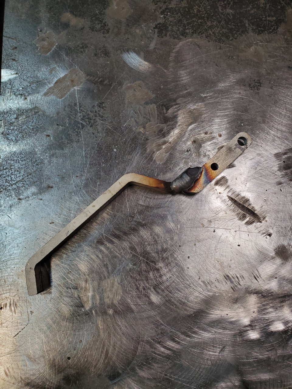

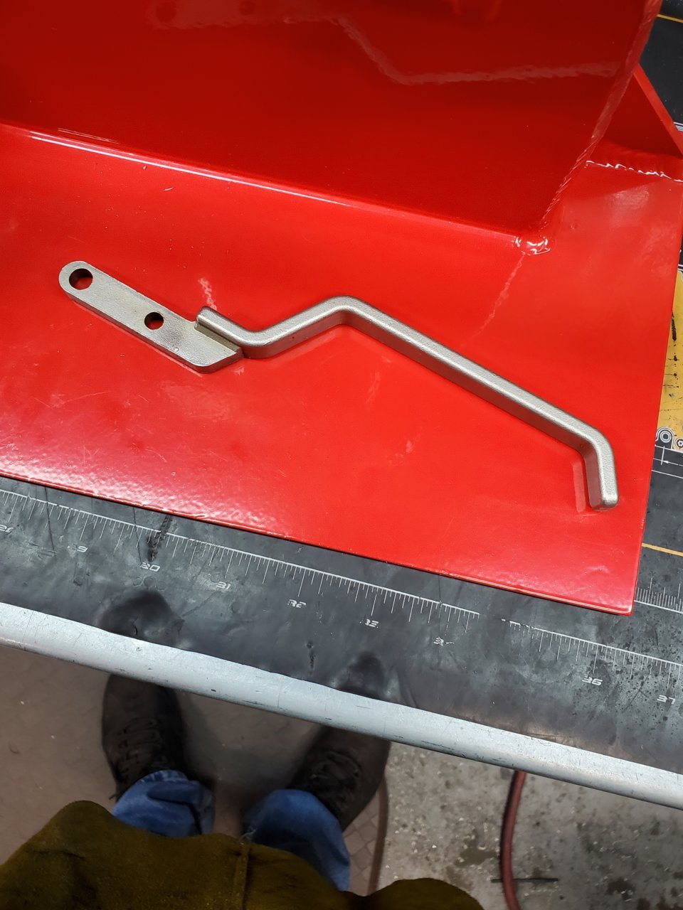

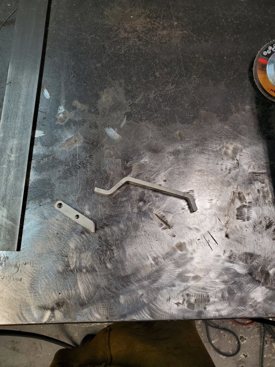

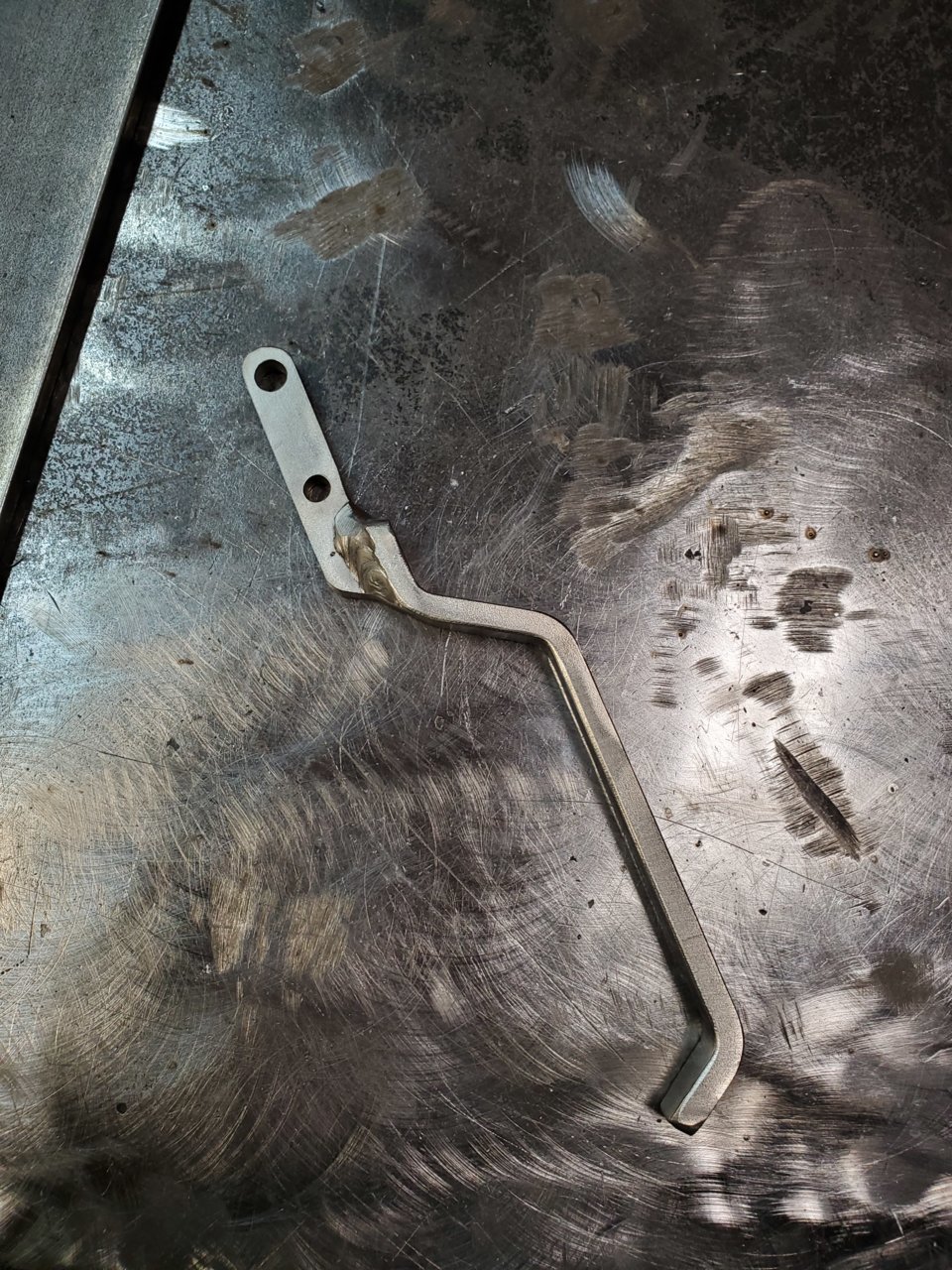

    This materials shortage stuff is really getting in our way here at work :( we have our triggers investment cast out of stainless and it's usually 4-5wk lead time. Now it's 30wks! My company got caught with it's pants down so we're hand crafting more and more stuff to keep up with production. The fun flip side is I get to practice and refine my fabricator skills lol
    Here's what the trigger should look like, all uniform and cast (this is the last one so I can use it as a template)20210923_075140.jpg
    Our metal supplier has a water jet so we bought 1/2" stainless sheet and had em cut out components 20210923_075035.jpg 20210923_075054.jpg
    Then I weld it
    And grind/wire wheel it to a more comfortable, usable handle20210923_075118.jpg
    Fabricating is way more fun than production welding, that's for sure

    You can turn your wire speed down if you want to move the gun that slow, or leave it and move faster, looks might save you a min grinding.

    Or tig it sans filler rod. Then theres 0 grinding

    Thanks for the tips, I really am just making it up as I go along:laughing: I was going slow to make sure the splatter sound was "cooking bacon" and not all choppy sounding
    This is the same mig welder, just swapped out the wire and gas for stainless.

    Truth, as long as it would be strong enough, can be a crapshoot on things like a handle

    Yea.... I need a shit ton more tig experience before I put it on a unit that a customer pays for lol

    TIG without filler is a lot easier than with filler if its thick material. But yeah, nothing replaces hours put behind the torch
