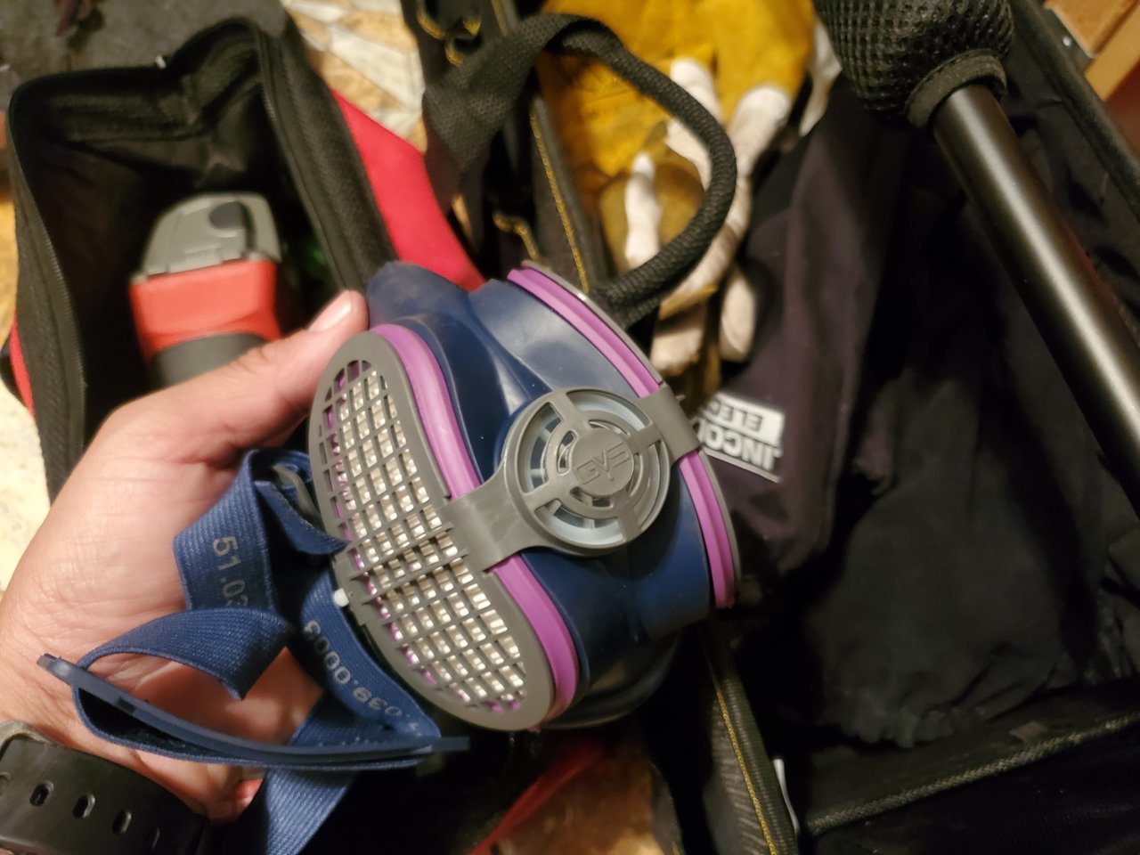

    4 run, 2 don't
    Holy shit what a difference today from using a respirator.
    Didn't even think about it until I was in my vehicle and thought, I don't feel tired at all and my sinuses are completely clear.

    Now you can safely make meth

    good call, your body will definitely thank you for that

    There are 11 students in the class; only one other guy uses one.
    Saw him using it yesterday (he's stick welding in the shop). When I put my burn table back in the shop at the end of the day, I could see the "dirty" air being pushed out. I told myself, the hell with breathing that in all day.
    So glad I got it yesterday because now I leave the burn table in the shop and do everything indoors.
    04Pre_Runner and Wulf[QUOTED] like this.

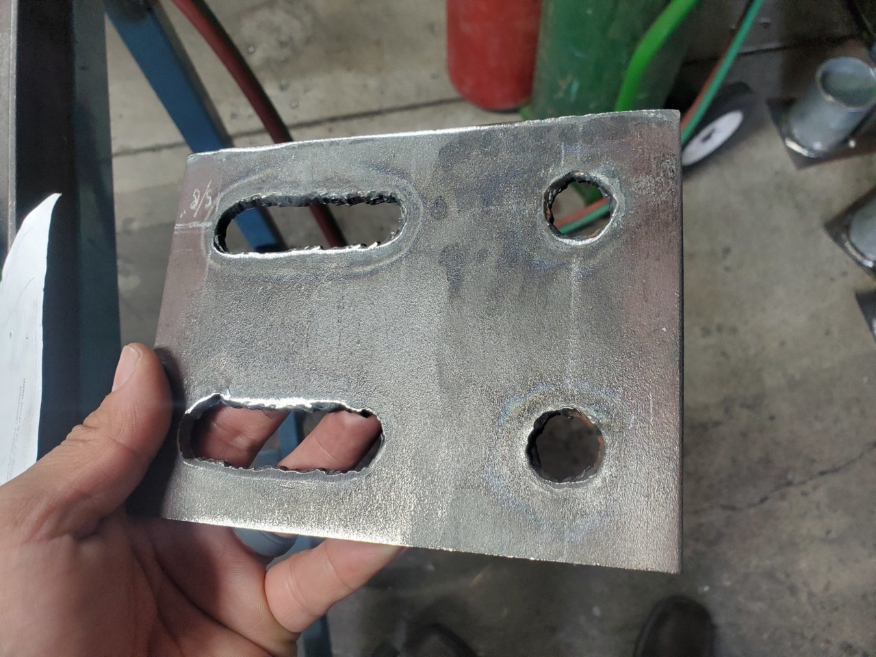

    Also, learned the importance of preheating the metal before moving the torch back out to cut material -
    Initially, I kept staying at the edge and trying to heat it up to cut. This just resulted in slight pooling as the metal thinned out towards the center.
    Placed the torch a good half inch or so away from the edge until it was orange-hot, and quickly moved inwards to cut.
    The circles came out much cleaner.

    oh yea, there is plenty of nasty shit in grinding/welding dust. I'm sure you've noticed after a couple days without the mask that your sinuses and throat feel it.
    Of course there are plenty of people who don't use PPE and never notice a difference... or they're used to it. Like people who swallow dip spit instead of spitting... there's no point in being tough if it hurts you
