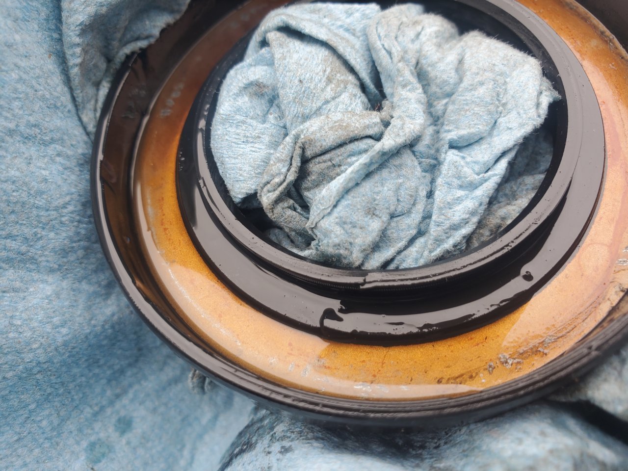

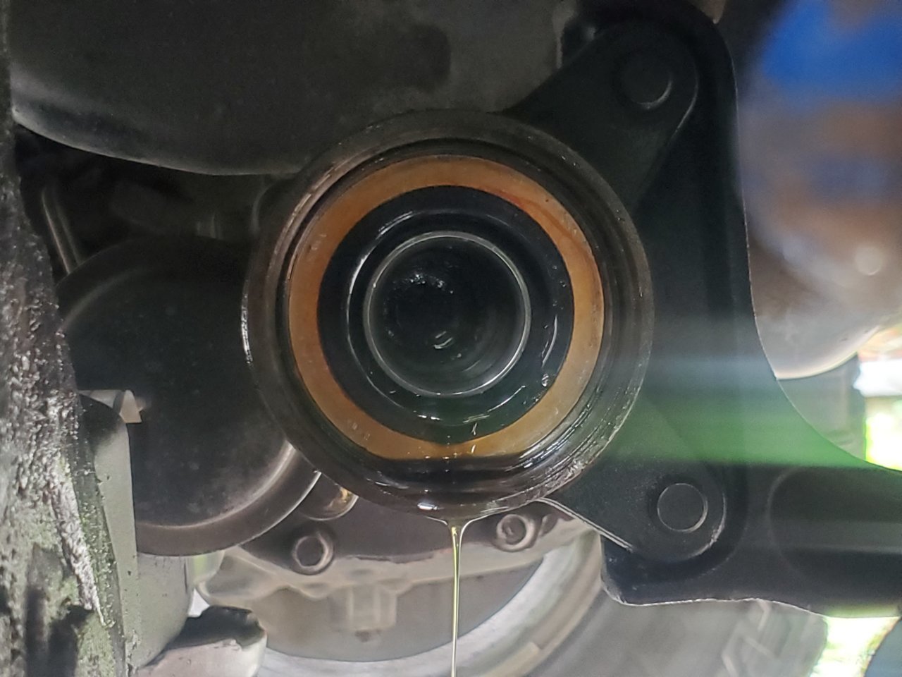

  18. Sep 26, 2021 at 10:46 AM
    Kwikvette
    Feb 27, 2019
    #284735
    81,970
    Fresno County
    4 run, 2 don't

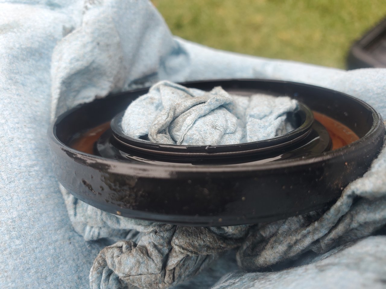

    @Speedytech7
    @CS_AR
    What do you think caused this?
    @eon_blue and I are replacing our CV axle seals; if you recall I replaced mine over a month ago. And I used the proper driver kit to drive the seal kit too.
    Why or how do you think this happened?
    It is torn in the center, exposing the spring. I remember the seal not being ripped when I seated it.
  19. Sep 26, 2021 at 10:49 AM
    Speedytech7
    Feb 20, 2014
    #123587
    58,250
    FCQM+VG Cheney, Washington
    It's less Tacoma and more mod
    Scotch Brite, just take the shine off, the surface the seal rides on on the CV, no Knicks. Make sure your bushing/bearing isn't super loose too. Pack some heavy grease in the back of the seal, all around the garter spring, fill that cavity. That keeps the garter from jumping off while you smack it in, if it jumps off it can get cause in between the seal and axle.
    CS_AR and Kwikvette[QUOTED] like this.
  20. Sep 26, 2021 at 11:02 AM
    Kwikvette
    Feb 27, 2019
    #284735
    81,970
    Fresno County
    4 run, 2 don't
    Here's how superficial the cut is -
    Going to use pvc pipe to tap the new one in and take your advice on the grease part -
