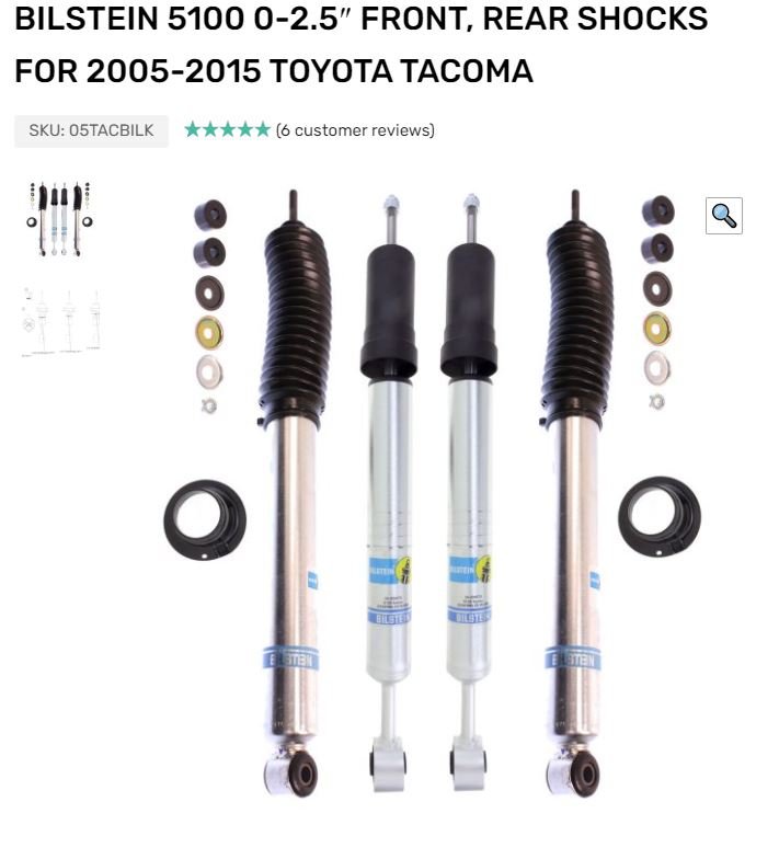

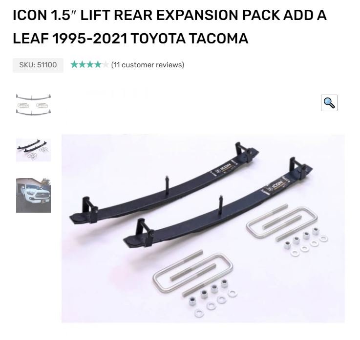

    I assume there's no real difference in doing front/rear suspension on a 2nd gen than a 1st gen, right
    Friend of mine with a 2010 bought a front/rear Bilstein kit (6112s I think) with UCAs and an AAL and wants to DIY. He's never worked on it before so I might have him come over and help him out. Figure there can't be much difference other than size of the bolts. I hear the UCAs are more of a pain on the 2nd gens

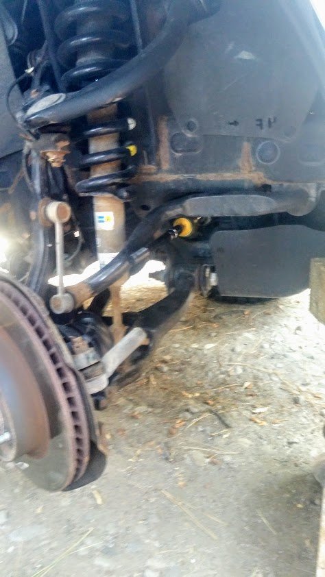

    Its pretty much the same. I think the 1st gen is a little easer on the front. The 2nd gen steering rack is in front of the CV axles and makes it a little harder to get the coil/shock out. But overall not to hard to do.

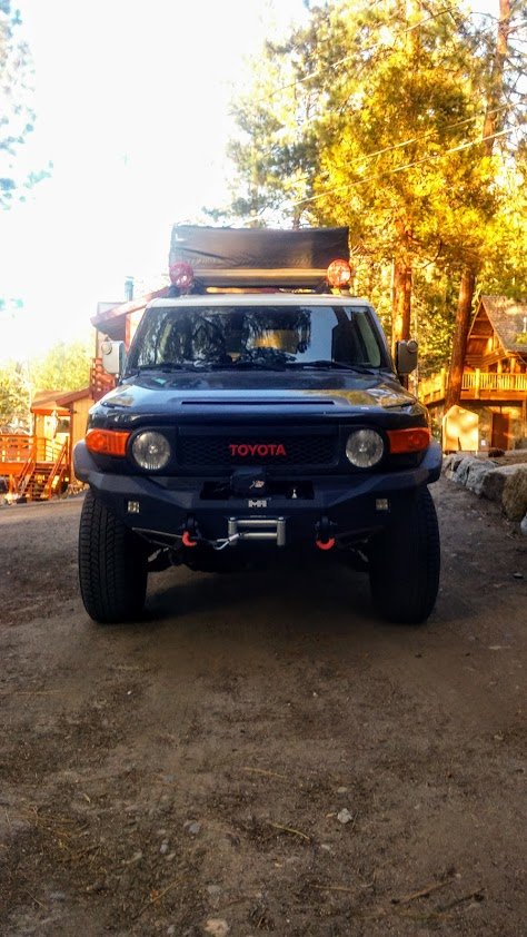

    Yeah the little more stuff is a pain. We did my friends FJ in a little less than 2 hours for both sides and it is the same setup as the 2nd gen. Don't forget to get some coil compressors.
