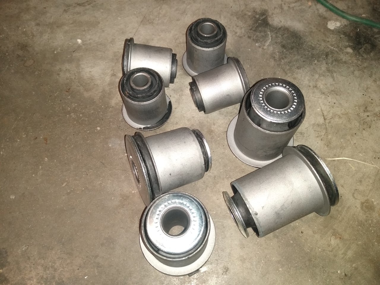

    I think you’re making it too hard.
    just use the bottle jack w/ to press them out, c-press to go in.
    for the bottom anyway.
    Fuck the top
  2. Sep 28, 2021 at 4:14 PM
    Running Board Man
    Running Board Man Well-Known Member
    Feb 19, 2017
    #211024
    8,802
    I've just never done it and have seen multiple ways of doing it
    The bottle jack method doesn't work when the rubber is already separated like on my truck
    the pressure you're putting on the inner sleeve is pulling the outer sleeve when the rubber is still vulcanized but
    when they're two separate pieces you just end up pushing out the inner

    That's just one way to do it, I've seen air hammers, torches, saws, press tools
    Just wanted to see what has worked for whoever has done it
    It would be great if my bushings were still one piece so I could give them a smack with some tension and have them fling out, but they arnt so I cant

    I took video of me doing everything except using the jack to press them out, sorry.
    You'll probably want to find a socket to press on the outside instead.

    Just got back from AutoZone where I found 2 to do just that
    I'll have to get a bottle jack... But still question how I'm going to do the uppers
    An air hammer I think is the answer
