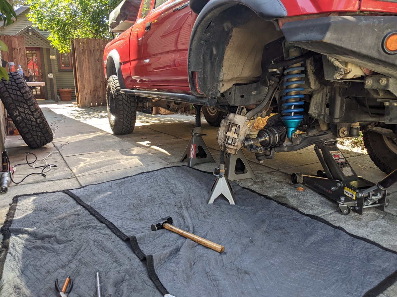

    Took the coilover out this time to give me more room to go straight at the seal. Really don't want to do this shit a 4th time lol

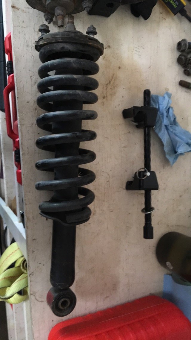

    my stock coilovers off the 04 that I was using on the 99 aren’t going to work with cheapo spring compressors. Nice.

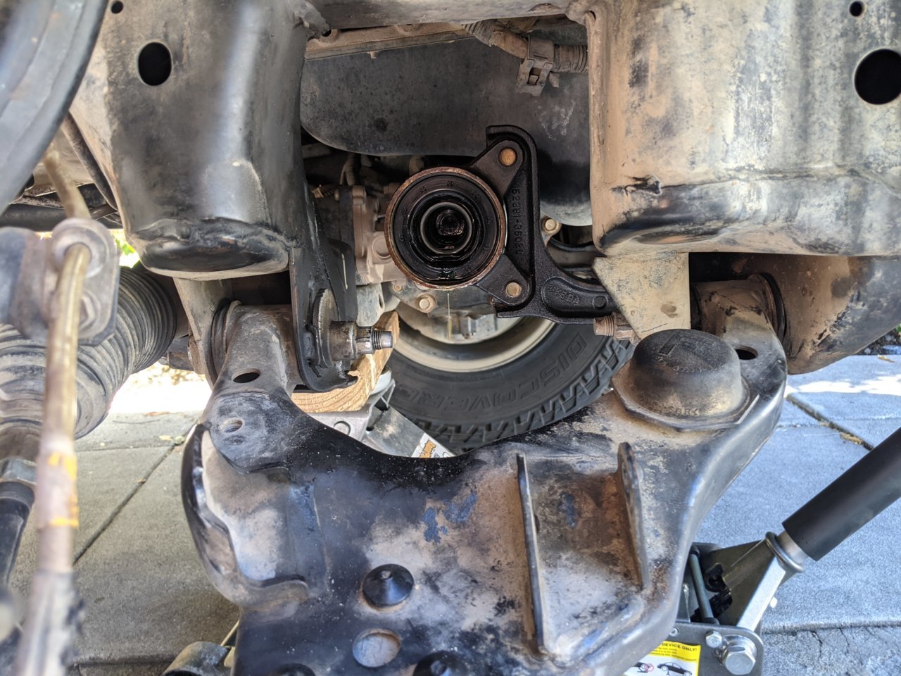

    Well that went in easier than both other times I did it. I froze it beforehand this time which probably helped. As did taking out the coilover so I wasn't having to fight around it. I'm 95% sure it's in there evenly, gonna send it :fingerscrossed:
    I did have to back it out a bit on one corner, hoping I didn't fuck the spring up on the seal in doing so

    Are you doing the lowers at the same time?
  13. Oct 2, 2021 at 12:53 PM
    eon_blue
    Mar 4, 2016
    #180213
    70,112
    Azusa, CA
    Nope, that's the other side. Not replacing the pass side lower, it's the driver one we suspect is bent
