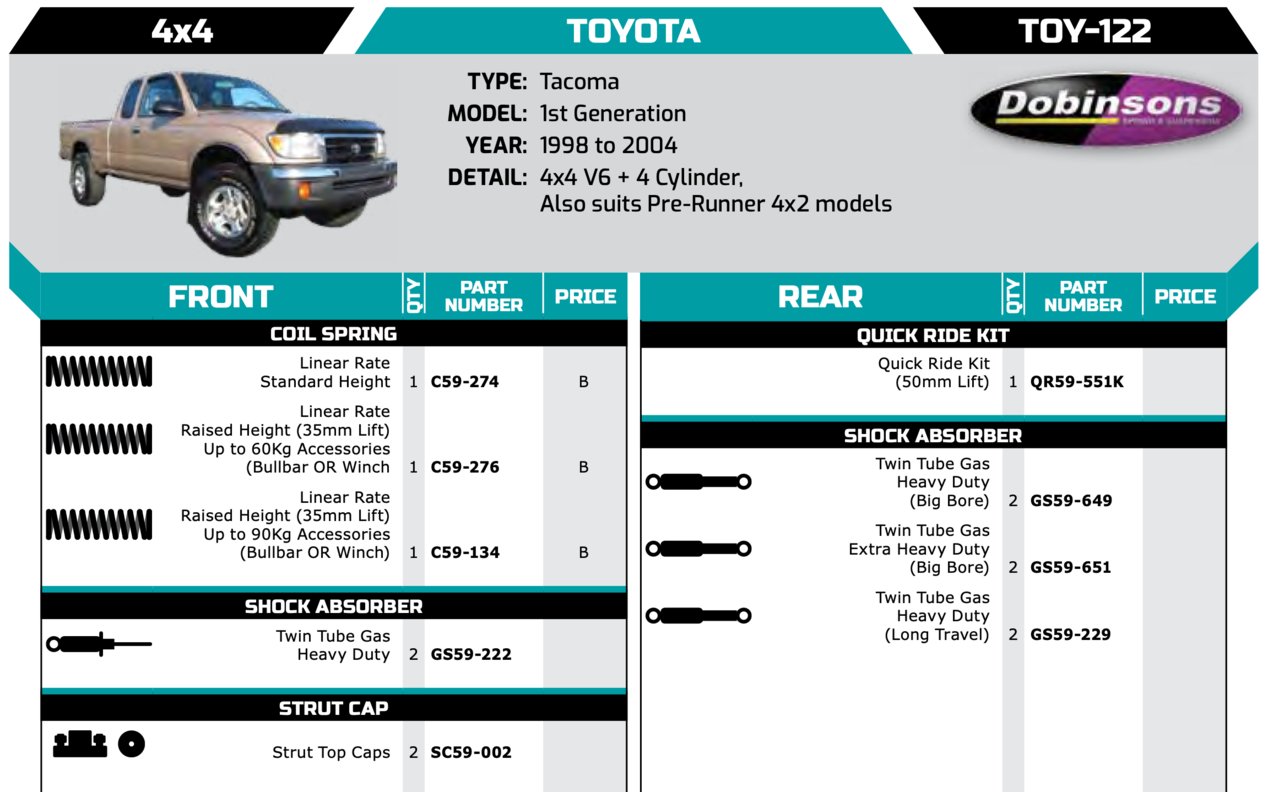

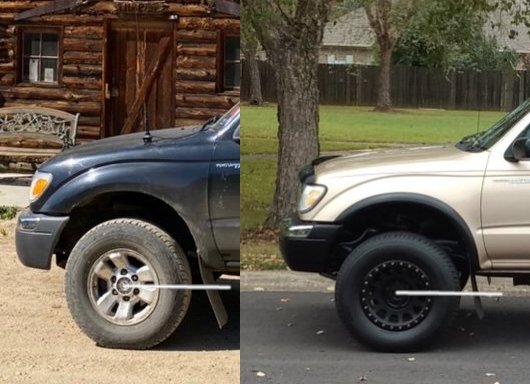

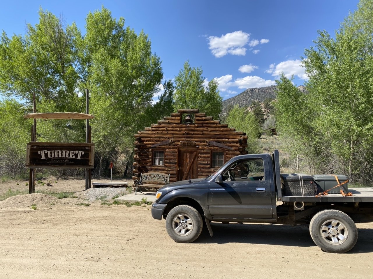

    Hmm indeed. I put adjustable shackles on the rear when i replaced my leafs, so if I end up taller I can proabably just tweak the rear to make it look right. Its already got a bit of a stinkbug stance anyway. Really tempted to just go with the 880's since there just isn't anything definitive.

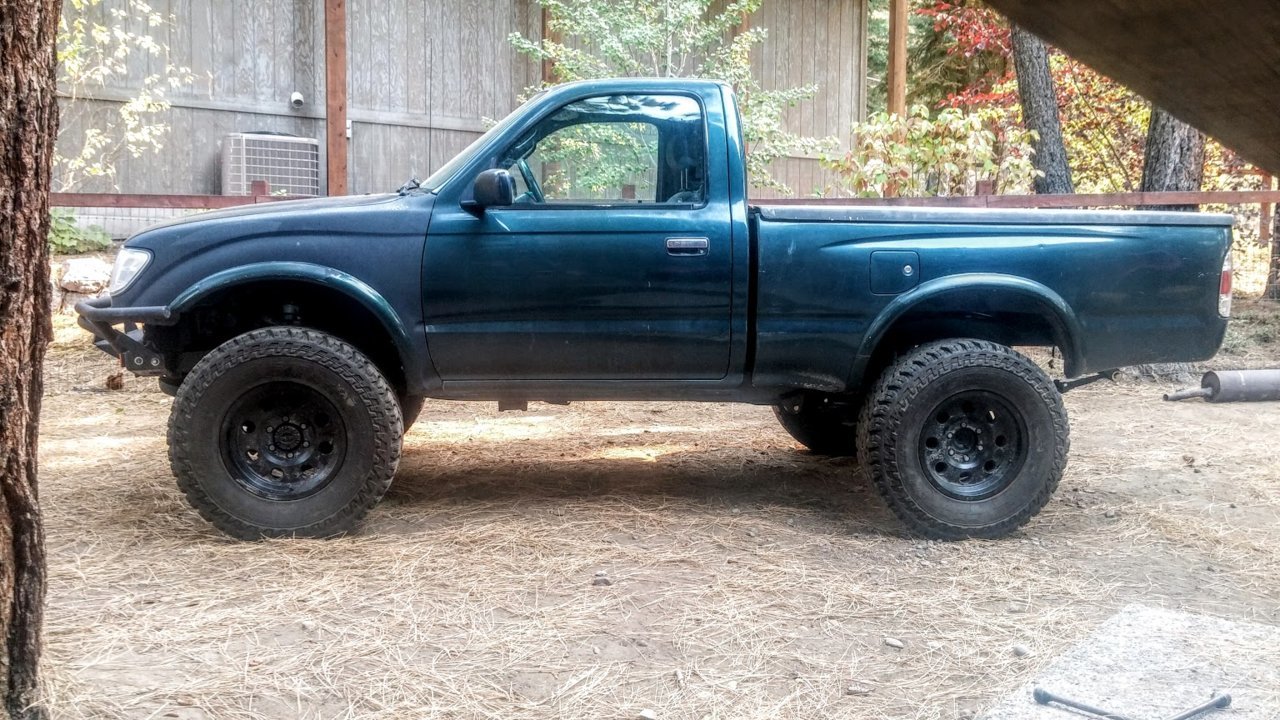

    Just for refrence.
    My truck with J59s But I also did custom shock mounts do to 97s having shorter springs. also on 255 85 16s

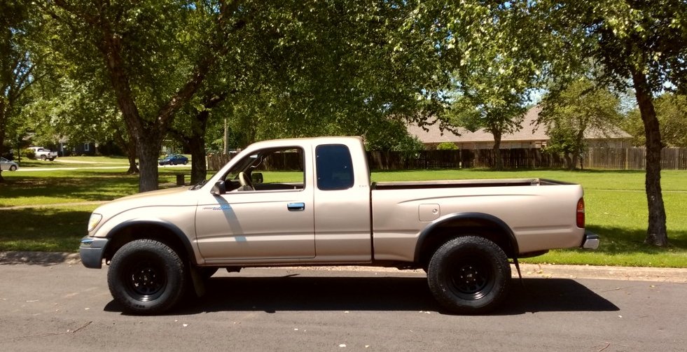

    Before with stock springs. The rear leafs were starting to frown a little. V6 Automatic 2WD.

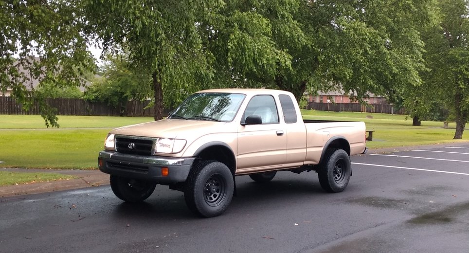

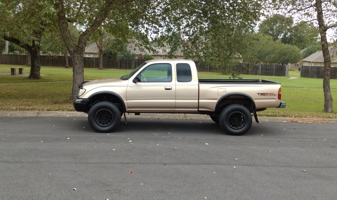

    After 880s and some Bilsteins on the front.
    880 Front
    Stock rear springs + AAL and a shim.

    I’ll have to sit down and compare those to this when I’m back at my desk. Center of the hub on yours is definitely lower relative to bottom of body than mine.

    super scientific over here. Given that your truck and my truck are roughly 65 lbs apart, i'd wager that i'd end up sitting about the same height on the 880s. Might be good enough.

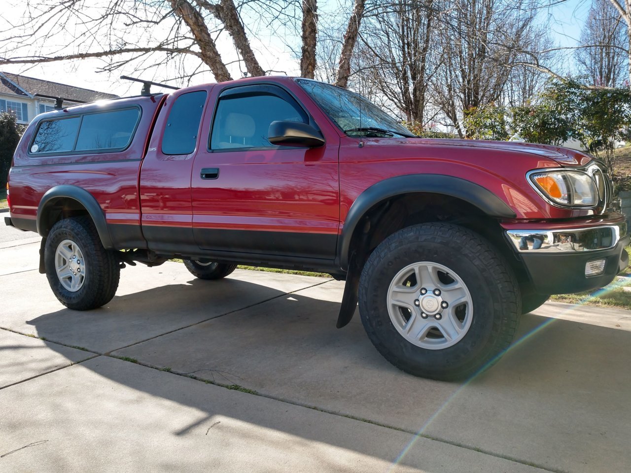

    Im on 880's and 32" tires. 1.5" add a leaf in the back.
    CS_AR and 0xDEADBEEF[QUOTED] like this.

    Not bad at all. Seems like a good fit.
