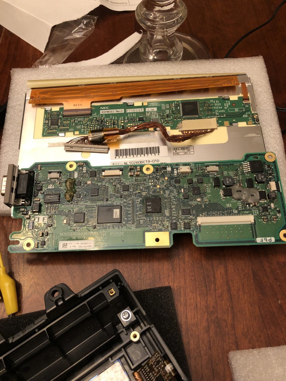

    I actually had to gut the thing and add my own drivers and inverters to get the LCD to work. It was hooked up to a proprietary controller.

    LVDS?

    It’s a nice NEC panel with LVDS. I had trouble sourcing a driver and inverter for it since the panel was only manufactured for industrial equipment (like airplanes).
    I just got a whole standalone system with a new panel and a new driver + inverter. Issue is it doesn’t pass through audio, and it’s missing the sound logic on the board itself. So I’m going to have to think of something creative to extract audio from HDMI.

    Sounds like a cool little project.
    HDMI audio DAC/splitter boards shouldn't be hard to find

    Yep! Looks like that’s going to be the plan. Some kind of HDMI audio extractor.

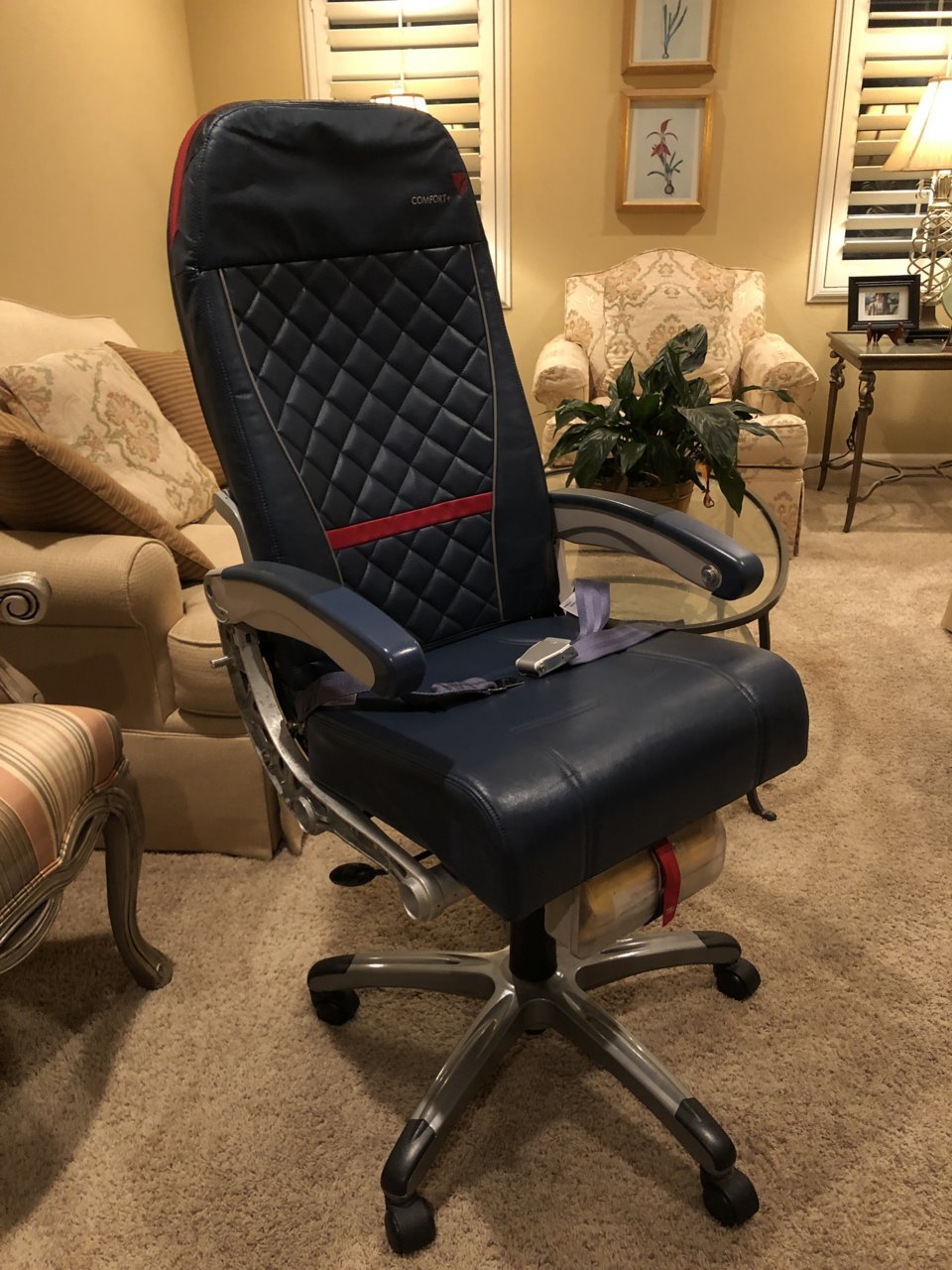

    @BartMaster1234 is going to build a flight sim room that’s just a passenger experience. Turbulence and a bag of pretzels included.
