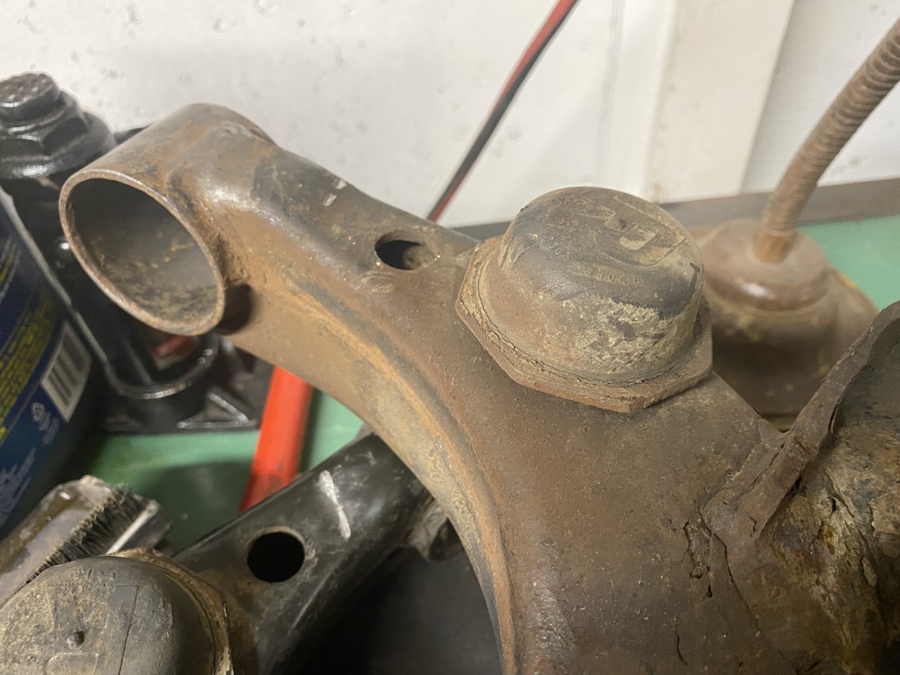

    Are these bump stops supposed to turn out or is Toyota messing with my head?

    4 run, 2 don't
    Pipe wrench, and they'll unscrew right off.
    They have a bolt coming out the bottom that screws into a factory welded nut in the LCA.

    Yeah they come off pretty easy surprisingly enough.
    Durobump stops are awesome, but if you're not wheeling, not worth upgrading them.
    Careful that the nut doesn't break like it did for @eon_blue
    He's got that fucker JB welded on the driver side :laughing:

    Yeah that weld nut inside the arm will snap off pretty easily, careful

    I never managed to get mine off, even with a pipe wrench. I think most people ignore the fender washers from Bilstein/OME

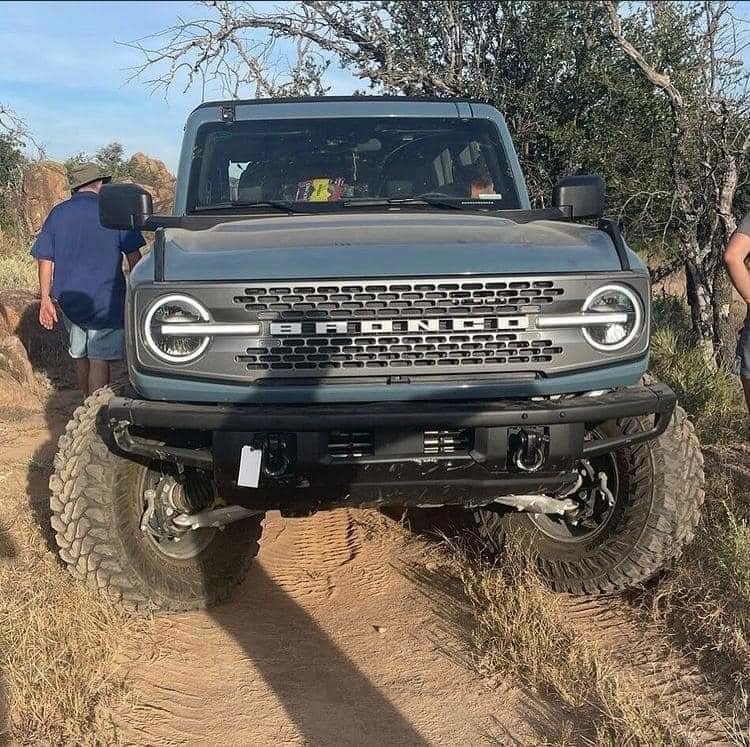

    WTF! Ford's fault or yours?
  16. Oct 19, 2021 at 7:38 PM
    JKO1998
    JKO1998 Well-Known Member
    Jun 2, 2015
    #156578
    52,905
    Utah
    WTH just happened
    Bronco:

    I broke them loose with the bench vise, then turned them with the pipe wrench till they were easy enough to turn by hand. Wasn’t too bad.
    What fender washers?
