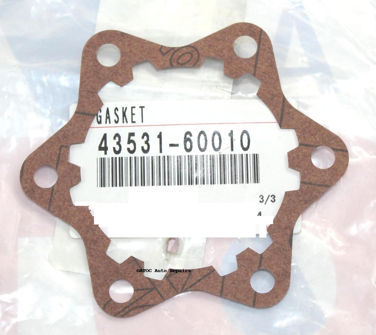

    I think these might be the locking hub part numbers from Toyota:
    Gasket - outer
    43422-60010
    Gasket - flange
    43531-60010
    not an O-ring, but kinda like an oring (ribbed...)
    43532-60010

    Here I thought I took pictures of all the part numbers.
    You're right about that ring too, there's a groove in it -
    I used Sil Glyde from Napa on that, and got the gaskets from Napa as well.
    tacotoe, Wulf and 0xDEADBEEF[QUOTED] like this.

    Oh I should check napa. Dealer here is slow as balls.

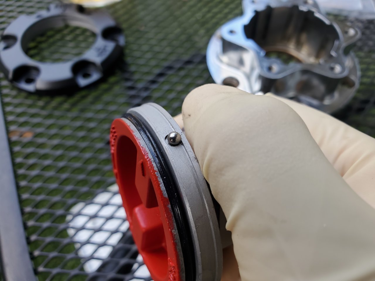

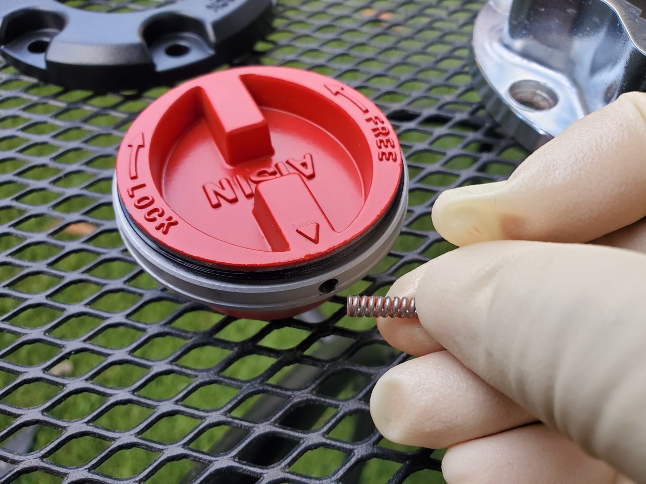

    I sourced an extra set of detent ball and springs from either Yotashop or some other place that begins with 'Yota'
    New ball shown above, here's the new spring -
    0xDEADBEEF[QUOTED] and Wulf like this.

    I believe marlin has the detent ball and spring as well
    Kwikvette[QUOTED] likes this.

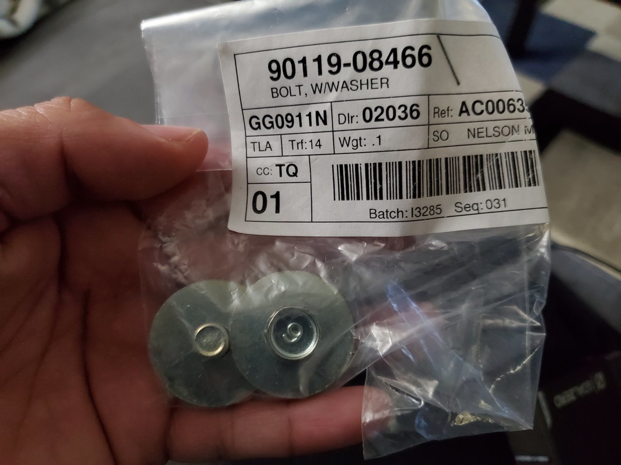

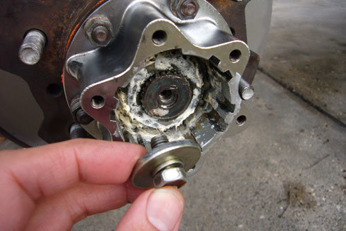

    Last but not least, you can replace the 2 bolts at the end of your CV axle.
    They're a back up to the retaining ring in the event that they fail. Really I've never seen those bolts in place myself but that's how they came brand new -
    69001d1199653652-converting-manual-hubs-_302f78ec4016132ea6d77382b375b9ce845fa4a4.jpg
    I've got a set myself in a baggie but I never did convert so they're in storage :anonymous:
    Part number for your convenience -
    tacotoe and 0xDEADBEEF like this.

    2000 reg cab 4x4 flatbed MT
    My bolts seem to be long gone :laughing:
    tacotoe and Kwikvette[QUOTED] like this.
